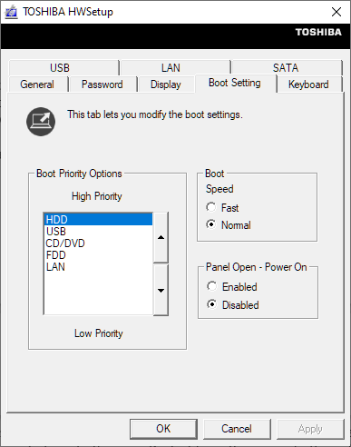

    Unable to Boot to BIOS Menu on Toshiba Laptop
    Welcome to TenForums Geoff.
    I have a Toshiba laptop (system one in my specs below). The bios skips the 'F2 for bios, F12 for boot menu' screen if you are resuming from hibernation. Windows 10's Fast Startup is a form of hibernation, so you either have to turn it off, or use Restart from the power button when you want to see the bios options. A Restart performs a full startup from cold and should (briefly) offer the F2/F12 options on the Toshiba logo screen.
    I did (once) get myself in a situation where it didn't. *Sad
    I had set the bios boot speed for 'fast'. Not being able to get into the bios, the only way to turn that off was with the Toshiba HWSetup tool.
    boot menu was not working on toshiba laptop 241356d1564160769t-unable-boot-bios-menu-toshiba-laptop-image.png
    If you do not have the HWSetup tool, go to the Toshiba support site and enter your serial number. You can download the one for your machine from there. The W7 one should still work in W10 (mine does).
