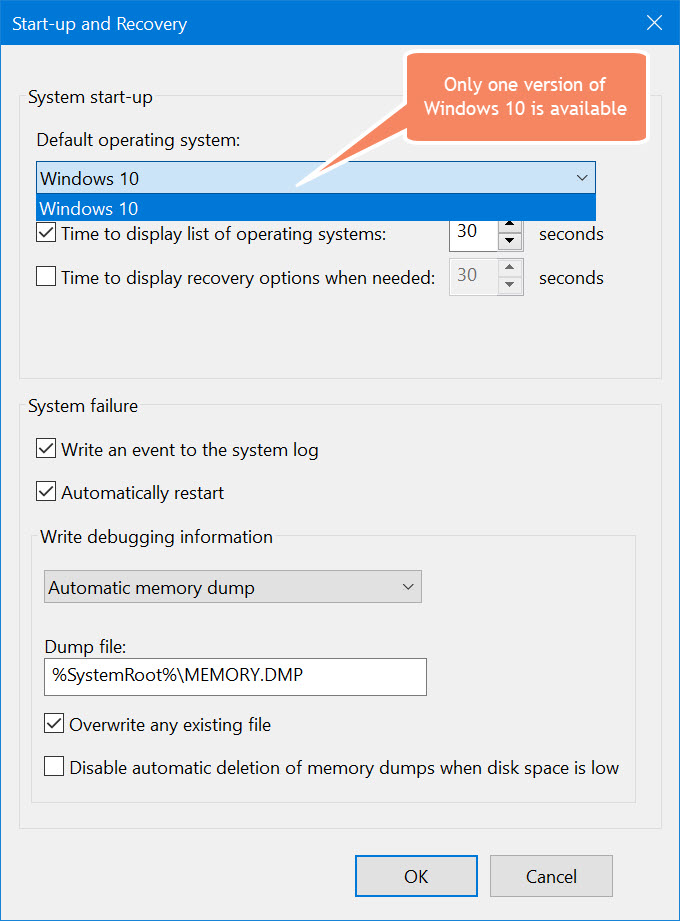

    I decided to install Windows 10 on a 2nd hard drive so I could boot between 2 separate installs. So I went ahead and installed Windows 10 on a 2nd SSD drive. Initially I got an error trying to install it but I solved it by disconnecting all the other hard drives. I then reconnected them after the install.
    The problem I'm having is I am unable to set up a dual boot screen in the System > Advanced system settings > Startup and recovery dialogue. It is showing only one version of Windows 10 so I can't choose between the 2 versions. Currently the only way I can boot between the 2 installs of Windows 10 is from the BIOS. Have done various searches but none of them relate specifically to using two versions of Windows 10 on separate hard drives. Any help would be much appreciated.
    Booting between 2 installs of Windows 10 on 2 SSD drives. d0d1ba0b-92de-4740-bd9d-3e0c177af213?upload=true.jpg
    Adralicus, Jan 29, 2019

  3. topgundcp Win User
    Dual Booting 2 x Windows 10 OS Drives (Existing Installs)
    It is uneccessary to do all of the above.
    1. Boot up Windows 10
    2. Open Disk Management and take a note of the drive letter of the other Windows 10
    3. Open Admin Command Prompt and type: bcdboot X:\Windows where X is the drive letter noted in step 2
    4. Reboot, you should have a dual boot menu.
    topgundcp, Jan 29, 2019
