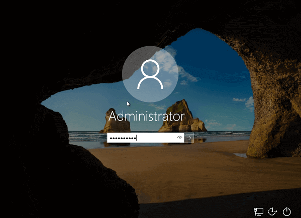

    I have just rebuild my laptop and all went well, except when I bootup now instead of seeing my name and a password box I see my name and below that the text 'Sign In'. When I click on 'Sign In' I get a Microsoft Account password popup request.
    How do I change this back to get a password box like this:
    Bootup Login - no password box, but MS Account popup 8b74b2a7-d4c6-446d-965c-8e4d23849647?upload=true.png
    JMUK, Dec 3, 2020

    Hi Helen,
    There could be changes made with the settings on your computer that has disabled the option to have users to log in with a username and password. This should be enabled back to get again the login window.
    If you're able to login to your system without using the password, please follow these steps to enable the login window during startup:
    • Right-click the Windows key and select Run.
    • In the Run field, type in control userpasswords2 and hit
      Enter.
    • In the User Accounts dialog box, check the box for Users must enter a user name and password to use this computer.
    • Click Apply, then OK.
    • Restart your computer and see if you're prompted with the login window.
    In case you can't login to your system, please boot your computer in Safe Mode. Check out the link,
    Start your PC in safe mode in Windows 10
    and follow the steps in From the sign-in screen. Once you're in Safe Mode, follow the steps above to enable the password prompt. Once done, restart your computer to go back to normal mode.
    Update us on how it goes so we can assist you further.
    Regards.
    "If you think this was useful, do not hesitate to mark it as answer
    to help those who are facing the same problem."
    Vanessa Yar, Dec 3, 2020
