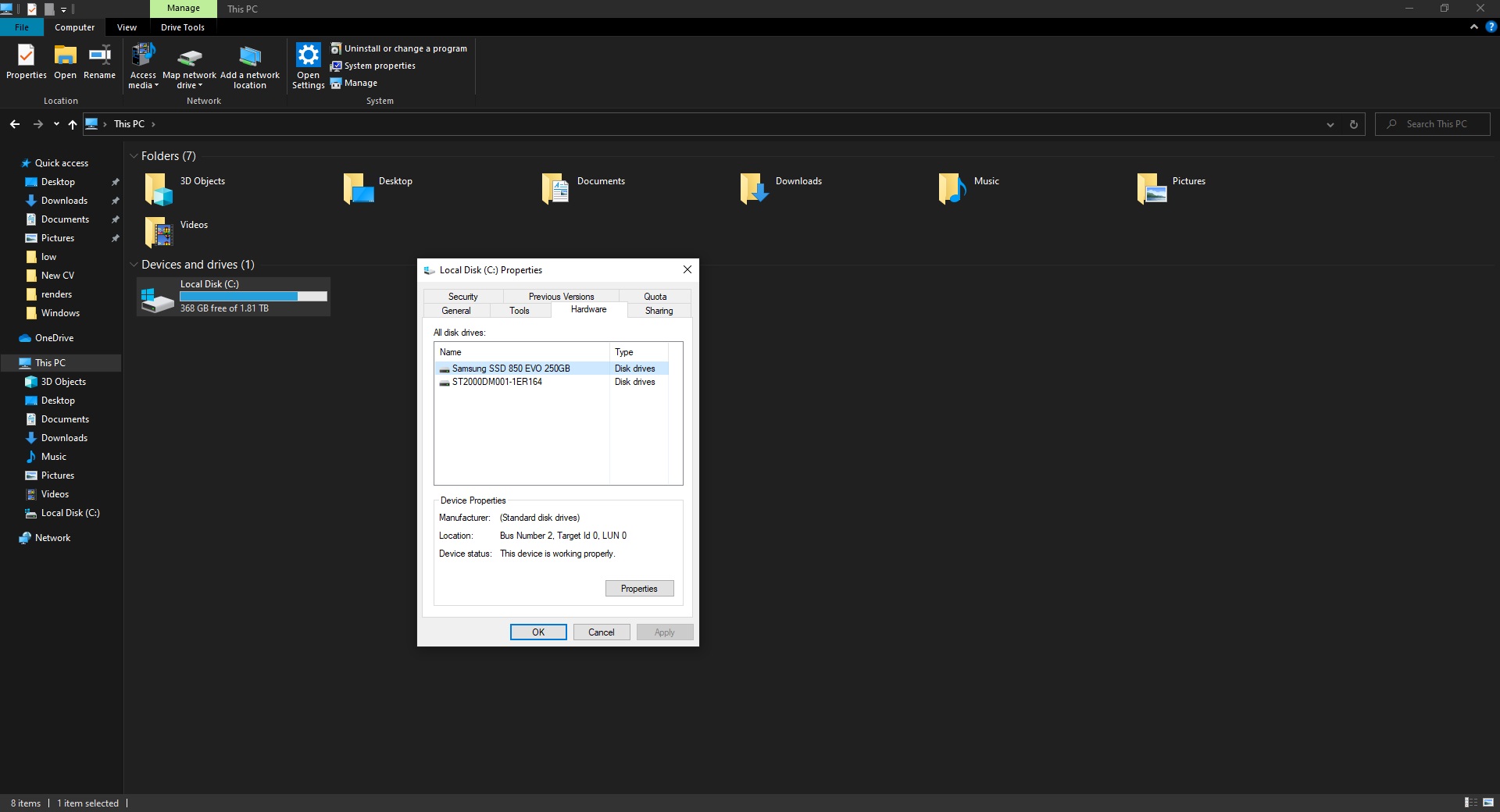

    This is my first PC build, I built it with some advice from a friend & I've been using it for a few years now. I used a Samsung 850 EVO 250GB as the OS drive & a HDD with 2TB for storage.
    The PC itself works fine, but I've always thought the boot speeds were a bit slow, given I'm booting from an SSD, but I didn't think too much of it & just accepted it for what it was, everything has been working fine after all.
    However I've been doing some more research into PC building & of delving back in to do a few upgrades. Though I have seen reports of others booting into their desktop in less than a minute using similar setups, whereas I can easily wait around 3 minutes.
    After watching a few build videos online, I've noticed that the boot drive is typically Local disk C and the storage drive is a separate drive altogether. Whereas both my SSD & HDD seem to be occupying Local disk C & that has me wondering if that is causing my boot to be limited by the HDD speeds in some way?
    Both OS Drive & HDD storage occupy Local Disk C 93a385f3-a8f7-42c1-a772-fbfea26bfe14?upload=true.jpg

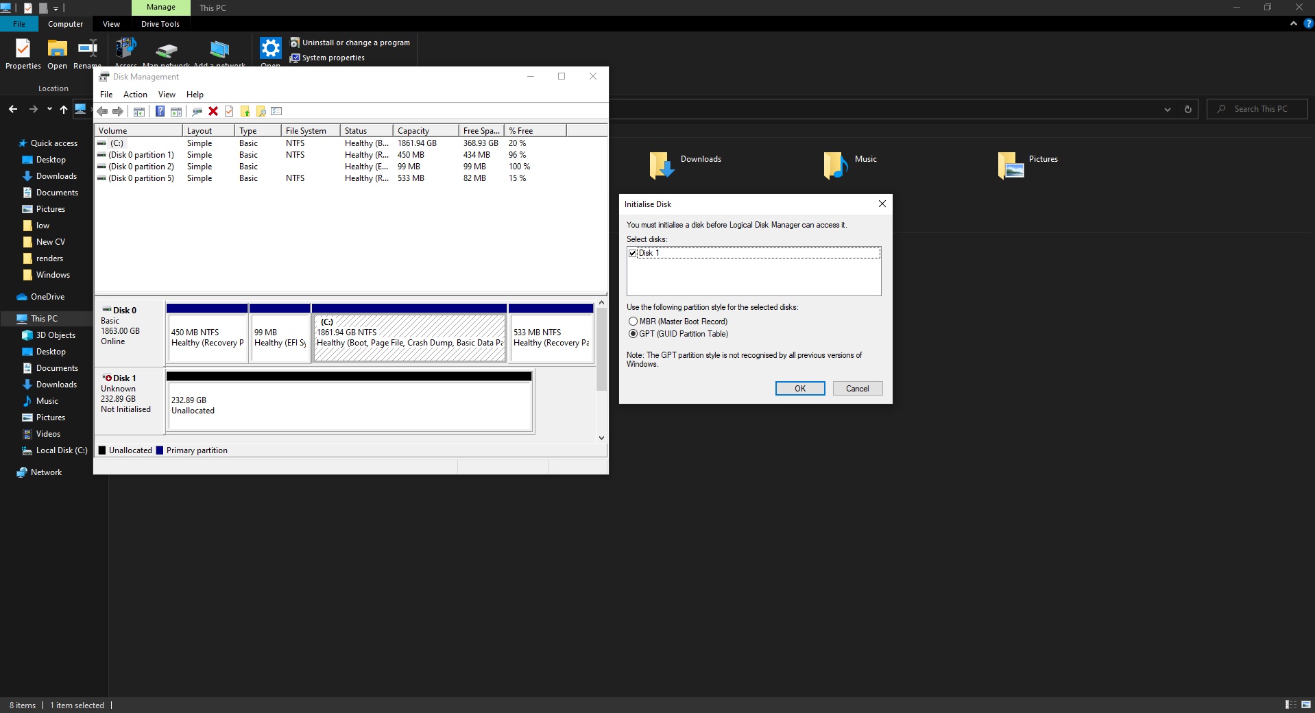

    When I go into disk management, it seems like my SSD on Disc 1 isn't being used at all & isn't initialised, though I know that the OS is installed on there, whereas Disk 0 which is my HDD seems to be taking on all the work. I've seen a video on Linus tech tips going over a similar issue, however it was his HDD that was unallocated, not his SSD boot drive.
    The video in question: https://www.youtube.com/watch?v=qMo8krAJd5Q&ab_channel=NCIXTechTips
    Both OS Drive & HDD storage occupy Local Disk C 793ce299-de18-4ac1-a806-c2cd9226be7d?upload=true.jpg
    I'm struggling to find answers for my specific problem and don't won't to risk tinkering around too much in case I mess up the whole system somewhere, so thought I would try asking here to see if anyone might know a solution to this or if this is how the setup should be?
