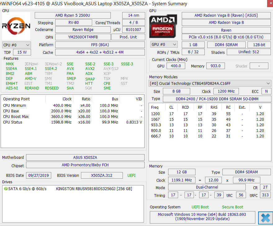

    Hi guys i know there are numerous posts about this but need a bit of help. I am recieving very random BSOD crashes. all are ntoskrnl.exe errors as identified using bluescreen view, i have carried out numerous tests as follows:
    1- updated all drivers directly from manufacturers support pages.
    2- updated all AMD chipset and video driver packages directly from AMD support pages
    3. ran memtest86 for 5hrs constantly and no errors showed
    4 ran prime95 to stress cpu for 12 hours and no crashes occurred
    5 removed and reseated the 8gb ram stick installed 4GB built in and 8gb is installed so 12GB total still errors occur at random but no fault on memtest
    6 gave up and complete fresh windows 10 install was done including total ssd format, this made it less frequent but has now happened twice since again always a ntoskrnl.exe error
    7. further memory tests ran for 12 hours constant with HCI Design memtest with memory under 96-97% load showing 0 errors
    the laptop specs are as per attached pic BSOD at random c5e83e7e-2adf-4ecb-833b-bc7303f3b751?upload=true.png
    https://1drv.ms/u/s!BJpjEn0eJ0V_wSPpgMwncJbTRegq?e=YdKVjy link to dmp files if it works.
    any help is appreciated it has now gone beyond my level of pc knowledge so please be gentle with me lol
