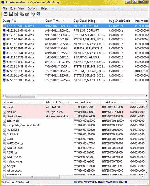

  3. bbmarley Win User
    BSOD randomly
    friend keeps getting BSOD
    any suggestions?
    bbmarley, Sep 20, 2018
