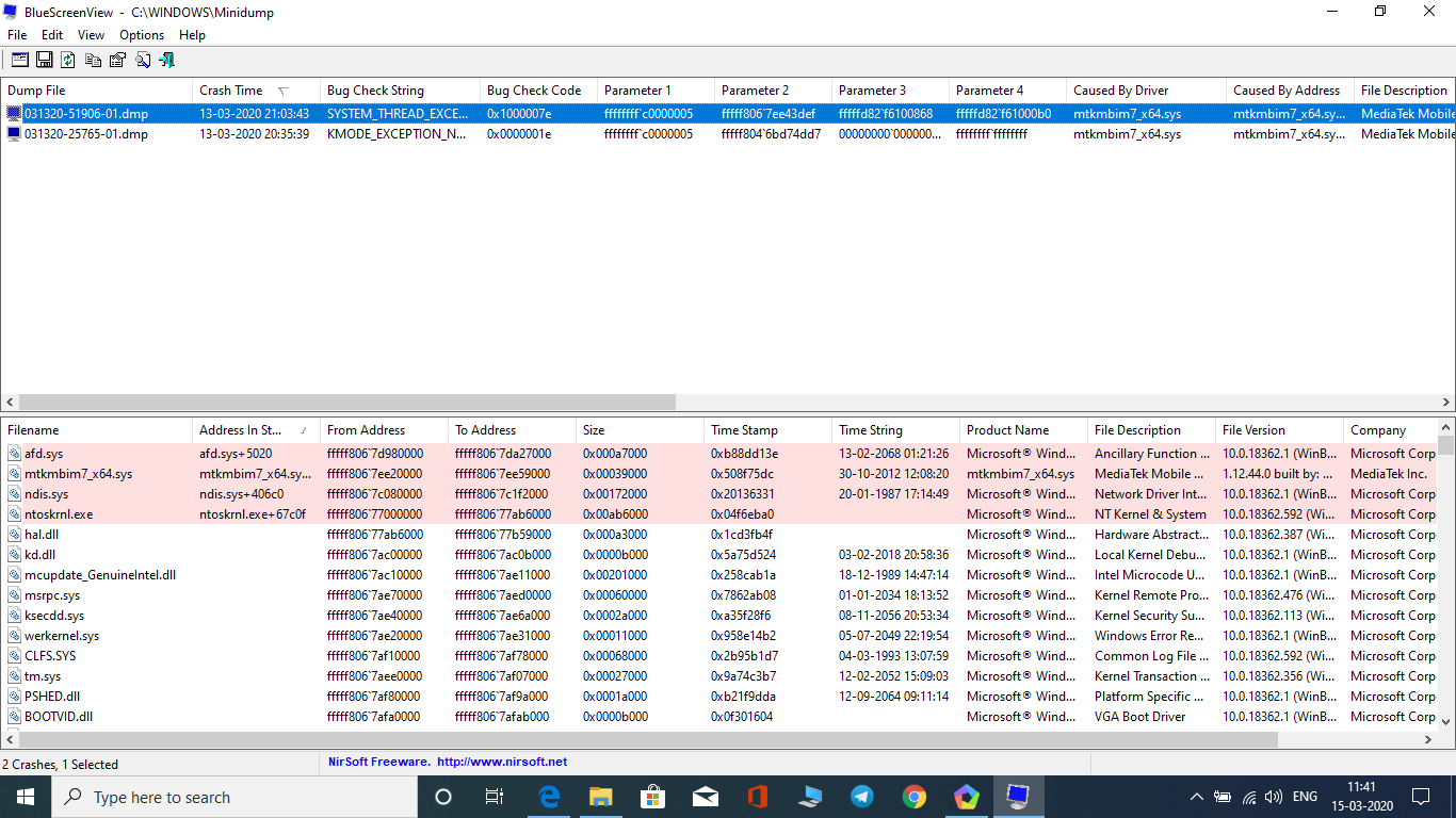

    from last 11-12 days I cant even use my laptop properly
    I keep getting blue screen of death and errors like System Thread exception not handled , KMODE exception not handled , Thread struck in a driver etc
    I have tried every solution available on Microsoft community and YouTube
    I tried troubleshooting
    repairing
    updating drivers
    uninstalling previously downloaded drivers and downloading again
    safe mode settings mentioned in you tube videos
    resetting my apps and setting removing them though it failed 3 times
    at last even reinstalling windows twice first without deleting anything and 2nd time deleting my c drive
    but the problem is still there
    KMODE Exception is Not Handled is the Most common BSOD error I get
    actually when I log into my windows it works absolutely fine but when I insert my dongle...… BSOD comes with KMODE and other errors
    if I connect to a hotspot then there is no error but with dongle it comes every time
    I don't have a wi-fi router so I usually surf net with my dongle as I always have been
    but I cant even use pc with it anymore please help me
    I am using HP pro 450 G2 Laptop
    and a D-Link dongle model DWP-157
    ManojKumar1515, Mar 15, 2020
