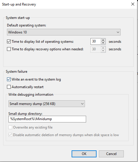

    Here are the event properties from some of the crashes. Note they are not the same (although there have been crashes
    with the same properties).
    Also, Windows seems unable to write dump files for crashes. I have the settings set up exactly as shown below, but nothing is ever present in C:\Windows\minidump after a crash. The same is true if I set it as a Kernel memory dump.
    BSOD Random Crashes "Kernel-Power" 9c4cf1fe-6db0-4ceb-9027-df6e8b2793e8?upload=true.png
    Any assistance would be greatly appreciated.
