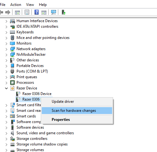

    I'm seeing my computer crash when returning from hibernate; event log includes events that say:
    Windows failed to resume from hibernate with error status 0xC0000001.
    Cursory googling suggests that this is a driver problem; using the driver verifier generates crashes that implicate a device driver rzDev0306 - I've uninstalled every Razer device from my computer that I can, but there are still two hidden devices in the device manager that use this driver. There is no option to uninstall these devices when I right click on them. See screenshot below
    Razer support has directed me to remove the drivers, but I can't figure out how. Any tips on how to remove these devices, and/or to figure out if its actually this driver causing my problem?

  4. Rey Cam Win User
    BSOD root causes
    Ntoskrl.exe Bsod
    Looking at the facts and your considerations;
    • This appears to be a typical software driver bug and is not likely to be caused by a hardware problem.
    • A third party driver was identified as the probable root cause of this system error.
    Doing basic troubleshooting steps to fix the BSOD issue might work. Please check
    Troubleshoot blue screen errors. Kindly choose the appropriate radio button as to when did the error occurred
    and follow the troubleshooting steps on the dropdowns.
    Let us know if any of the solutions provided worked for you.
