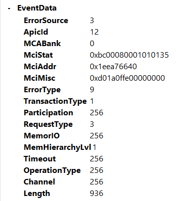

    Hi, I recently switched my PC Motherboard, CPU, and RAM to a gigabyte X570UD mb, a Ryzen 5800x, and Corsair Vengeance 3200MHz DDR4 ram 16gb.
    At first I only Blue Screened while playing FFXIV but I recently got it for the first time in another game as well. I have the latest bios, chipset, and graphics drivers. I did a memtest, sfc scan, checked my storages, did a virus scan, and windows said it was all fine. Does anyone know the cause of this? It seems to say that it is related to my processor, and I thought it was maybe because I installed the cooler badly but my temperatures are normal. I can use my PC fine, and it never blue screens, but this only happens in games, like I said specifically FFXIV.
    This is my Event Log:
    A fatal hardware error has occurred.
    Reported by component: Processor Core
    Error Source: Machine Check Exception
    Error Type: Cache Hierarchy Error
    Processor APIC ID: 12
    The details view of this entry contains further information.
    Details:
    BSOD Whea_Uncorrectable_Error on new CPU. b8e08ffe-1d03-454a-8234-68c2946c22e3?upload=true.png
    BenNet1700, Dec 19, 2020
