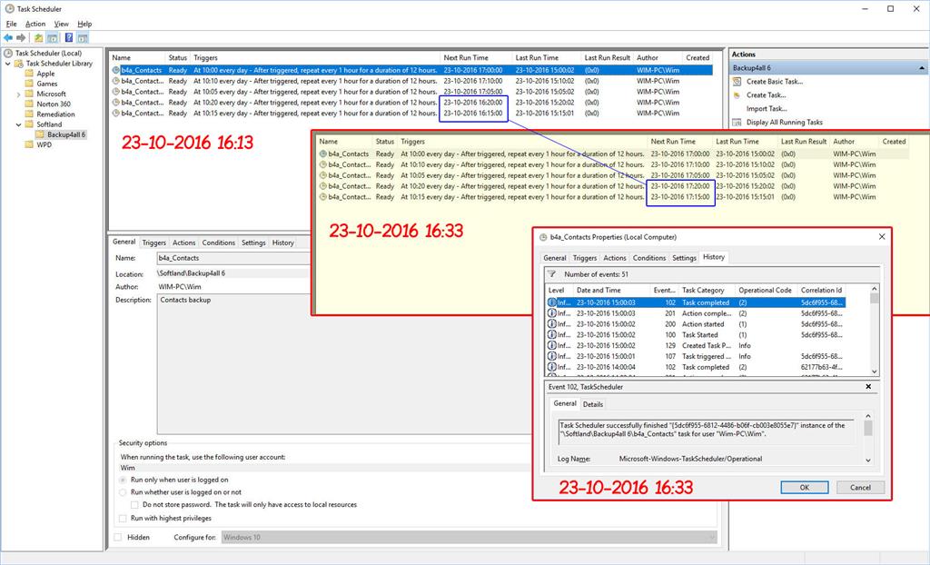

  4. Wim Spaak Win User
    Bug? Schedule task trigger a day before & on next start-up after schedule, All Win10ver
    Windows Task Scheduler does not trigger a task, after a PC-restart during the day
    The problem:
    I started my PC before the first Backup4all (my backup program) task schedule (at 10:00) and during the day all Backup4all backups were made correctly, with an interval of the programmed 1 hour.
    At 15:45 I restarted my PC. No Backup4all backups were made from the moment the PC was restarted.
    At 16:13 I made a screendump of the Windows Task Scheduler (see below).
    Bug? Schedule task trigger a day before & on next start-up after schedule, All Win10ver b43ad53d-5d98-4608-a280-27c1eed84187.jpg
    You
    can see in the attachment that Windows Task Scheduler updates the Next Run Time at about 16:00, but Last Run Time remains on the one before PC-restart.
    So Backup4all is not triggered by the Windows Task Scheduler to backup.
    At 16:33 a made a screendump of the Windows Task Scheduler screen again and you see in the blue frame that the Next Run Time is updated, but Last Run Time is not.
    I also enabled the Windows Task Scheduler History and at 16:33 you see that the last event was from 15:00
    Finally I used the Action "Run" in the Windows Task Scheduler at 17:17 and Backup4all started the backup successfully at 17:17:09.
    Now the Windows Task Scheduler History also shows an event: that the task is completed
    It seems that Windows Task Scheduler triggers the backup job correctly, when the PC is powered-on before the first task schedule time. After a PC restart or a daily power-on after the first backup should be made, the backup program is not triggered by Wimndows
    Task Scheduler anymore.
    I tried this by both the “Run task as soon as possible after a scheduled start is missed" checked and unchecked. In case of a check, the backup tasks are still not triggered by Windows Task Scheduler.
    Does anybody has a solution for this problem, or is it a bug in the Windows Task Scheduler ( the problem started to occur a few month ago).
    Wim Spaak, Sep 21, 2020
