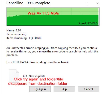

  3. IanPurdie Win User
    Build 1803 causing copy "Error Code 0xC00D426A: Error reading from the network %0 over LAN"
    Windows a few weeks back upgraded my desktop from Build 1709 to Build
    1803. There is no Windows.old file now.
    After upgrading, I am facing problems in Windows 10 regarding
    copying folders [with files] across my LAN from my Video STB.
    I have done this successfully for a number of years - until now.
    When I now try to copy folder/files from the STB to my external drives
    attached to the desktop, the speed fluctuates frequently. In case of
    External hard disk, the copy speed reaches the normal 11 MB/s and
    instantly drops down to 0 byte/s.
    Build 1803 again causing copy "Error Code 0xC00D426A: Error reading from the network over LAN" b3a2e065-f307-4ce8-8939-2486553032f2?upload=true.jpg
    The STB is a 10/100 network owing to the internal controlling IC being
    10/100. Past average transfer of folders/file was always around normal 11.3
    MB/s.
    IanPurdie, Nov 10, 2019
