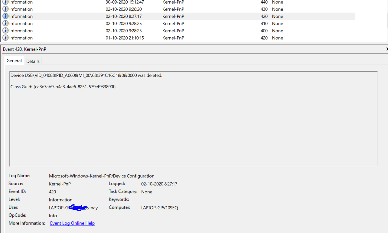

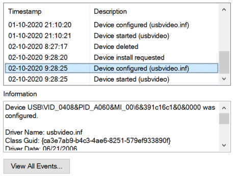

    yesterday, I tried opening my camera and got the error
    0xA00F244 no cameras attached
    well, then I found that my camera driver was listed in hidden drivers in the device manager. Then I went through 10-20 discussions on the Microsoft site, tried uninstalling the driver but then after a restart, it disappeared even from the hidden drivers' list. Then I tried watching some youtube videos, did all the basics-
    1. reinstalling drivers didn't work
    2. resetting windows didn't workbig surprise
    3-4-5.then I downloaded further windows updates after just resetting it. I don't know why they were available after a cloud reset but I checked for updates and since they were available I downloaded..then for the camera problem I tried creating the "DWORD 32-bit Value. Name this DWORD EnableFrameServerMode." thing. after this, I also ran the hardware troubleshooter using the "msdt.exe -id DeviceDiagnostic" command using windows+r and then I restarted and my driver was back in place.
    So I don't know which of the above worked for me.
    sadly, after half a day when I restarted my laptop the driver was gone again and I don't know what all I did this time but after a few restarts the camera was back again
    after all this I was frustrated and knew it will happen again and so I restarted after a few hours and the driver was hidden once again. This time I tried
    1. going into BIOS and change settings to default, that didn't work.
    2. doing scans like sfc scannow and dismdidn't work
    then I removed the last 2 windows updates and restarted, now my camera driver is back and he camera is working but I don't know after which restart it will be gone.. i don't know if that is a windows update problem or just a windows problem in general.
    I think it's an update problem since the camera stopped working after one or two restarts after updating. Still, I am not sure. What should I do?
    I am attaching 2 pics showing that the device was deleted and some information that might be useful for a technician.
    this is before I uninstalled the 2 updates.
    For time reference, I restarted my computer after uninstalling at 9:25, 02-10-2020
    vinaychahal, Oct 2, 2020
