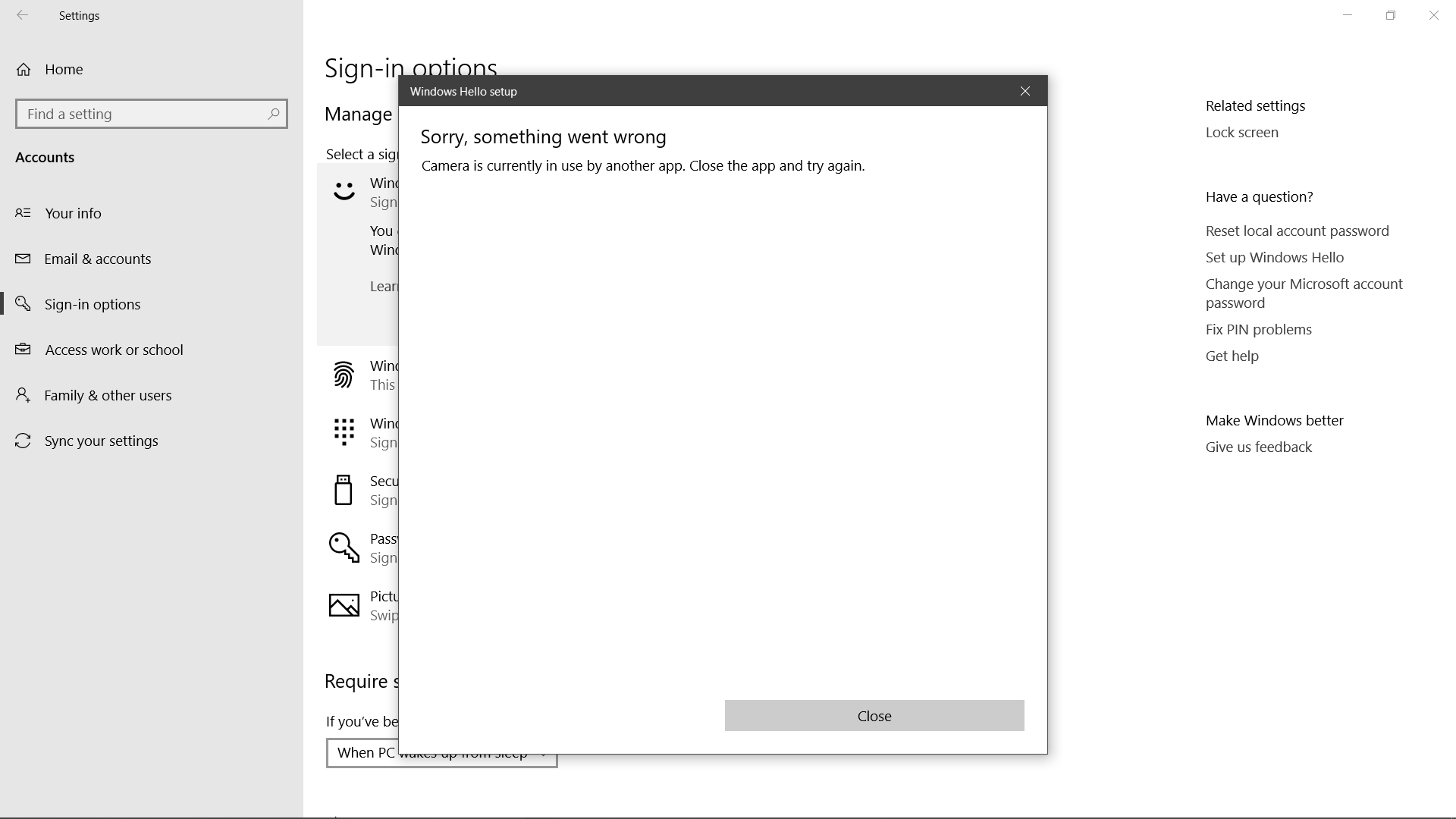

    Hi, I am using the HP Envy x360 Convertible 15-bp1xx and I am having a problem setting up the Windows Hello Face. After I type in my PIN, I continue and the light beside my camera lights up but it says something went wrong and the camera is currently in use by another app. I've tried restarting my PC, troubleshooting and updating my drivers and nothing worked. I'd appreciate it so much if anyone would be of help. Camera is being used by another app - Windows Hello Face Setup 909ffda6-02b0-4c47-b7e2-9a7652f900e1?upload=true.png

    I resolved my problem by updating the drivers for my camera. The steps I took were:
    • elect the Start button, typeDevice Manager,
    • When the list of results popped up I expanded the Imaging devices option, which showed the camera on my computer.
    • Right clicked on and selected update Driver.
    • Select Search automatically for updated driver software.
    I restarted my computer. Windows Hello started and accessed the camera. I hope this helps.
