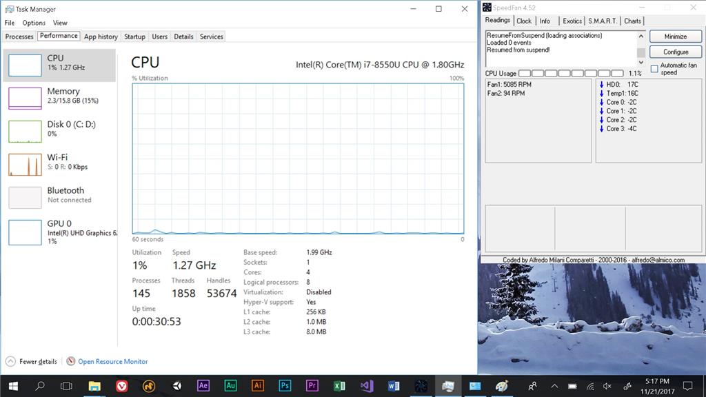

    Notebook, always-on fan, NOT temperature or high process related
    My HP Spectre X360 with 8th gen Intel appears to be booting into 1 of 2 modes, there doesn't seem to be any indicator or cause for which will be experienced and the difference is whether or not the system fan is set proportionate to the temperature of the
    system.
    • [Most frequent] Fans are always running at over 5krpm, they do not go below this ever. At high load they will increase and when the load is gone and temperatures lower the fan speed will lower again to 5krpm. This will happen regardless of resource usage
      and temperature (see below screen capture)
    • [Uncommmon] Fans only run when the system gets hot and when it cools down they stop again. From testing the fans can stay off until the system hits 75C
    The only way I have been able to achieve #2 is to restart repeatedly until upon login to Windows there is no fan running, this mode will stay until I restart again or the computer goes to sleep. It has been my experience that mode 2 NEVER happens when waking
    up. So if I get mode 2, put the computer to sleep and then wake it up, it will always be mode 1.
    I have tried various power plans and power settings, both active and passive cooling policies, this happens on battery and plugged in, same experience when booting into SafeMode. The fans are system controlled but something seems to be... wrong.
    Initially on Windows 10 1703, upgraded to 1709 and the issue remains. Thank you in advance for any ideas you may have!
    Can I Set At What Temperature The Fan Turns On In The Bios? 4d1b1760-a29c-4876-8033-48cddf99ab79.jpg
    zim12345, Mar 30, 2019
