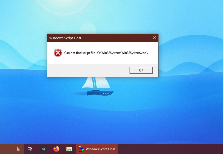

  1. can not find script file "C:\win32System\Win32System.vbe".
    i have been getting this error on screen everytime i boot my laptop.
    can anyone help me in solving this issue.

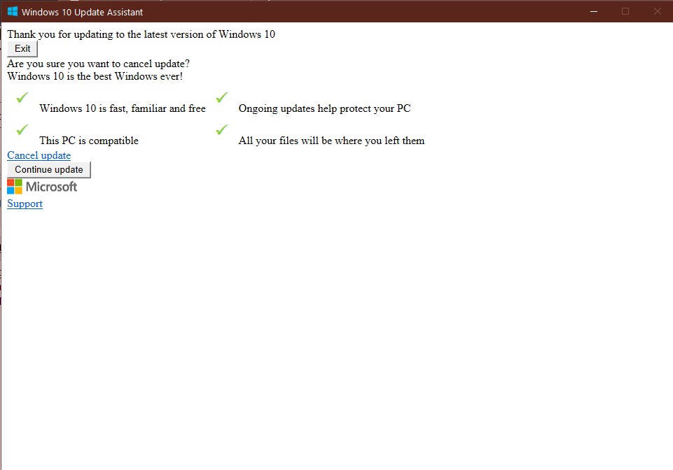

    Also i face some display issue with few of apps like netflix and microsoft update assist . where content is not displaying full to the screen.
    Thank you in advance.
    can not find script file "C:\win32System\Win32System.vbe". bf88954b-33ff-4ac7-9362-c9a07182743f?upload=true.jpg can not find script file "C:\win32System\Win32System.vbe". 1d9fed4c-eede-49cd-822b-ebea0477c423?upload=true.jpg

  2. I am getting this pop-up at start up : Can not find script file "C:\Win32System\Win32System.vbe"
    After scanning my PC with AVAST, I restarted it and I am getting a pop-up
    What does this mean?
    How do I fix this?
    Is it some kind of virus?
    Please help me

    The missing file contained some malware or a virus that your virus scanner dealt with. The error message appears because something is still trying to invoke the script. The simplest solution consists of giving the "something" a bone to chew on. Here is how
    to do it:
    • Create the folder C:\YtCmisiZsC.
    • Mark the code line below with your mouse, then press Ctrl+C to copy it.
    • Press then Windows key, then Ctrl+V to paste the code line.
    • Allow the file to be created.
    • Type this single line: wscript.quit
    • Save and close the file.
    notepad C:\YtCmisiZsC\YtCmisiZsC.vbs
    Frederik Long, Nov 14, 2019
    Can not find script file error
    This could be due to a missing script file or that an application is causing the error. As a first troubleshooting step, we suggest that you locate or navigate to the location listed in the error and see if the file it is looking for is there. If you are
    unable to locate the file, an application is causing this error to pop-up. If that is the case, we suggest that you boot your PC in Safe Mode and see if the error still pops up. You may follow the steps on this
    link on how to start your PC in Safe Mode.
    If the problem does not exist in Safe Mode, we would know that an application is causing the error. However, if the problem is presented while in Safe Mode, the problem may be caused by Windows itself.
    We look forward to an update from you.
    David Haz, Nov 14, 2019
