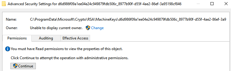

    The problem is that no matter what I do, I cannot add an owner to those 3 machine key files. I've tried following the steps there and I've tried using takeown from the command prompt. No matter what I do, the file always returns to this state:
    Cannot Assign Owner to a MachineKey File Needed to Start Windows Process Activation Service... 93cdf1d2-81ad-4c2b-9330-d5c38579eebe?upload=true.png

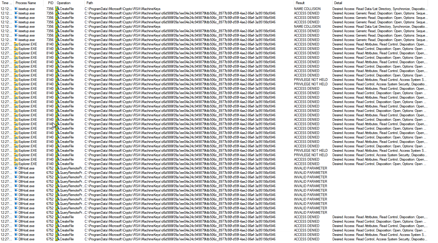

    I also tried to isolate the error using process monitor, and here are all of the problems when I tried to change ownership of one of the machinekey files:
    Cannot Assign Owner to a MachineKey File Needed to Start Windows Process Activation Service... 19cc9a94-8169-4e7c-8d0a-d91a0d536022?upload=true.png
    Because there is no owner, I also can't delete the files.
    I'm really at a loss of how I can either delete or change the owner of these files. Any help would be appreciated..thanks.
