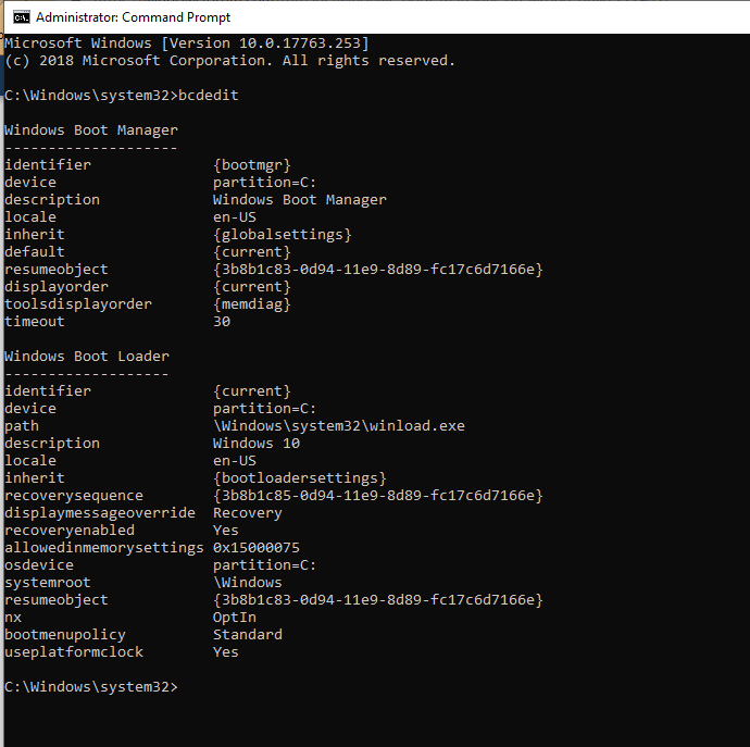

    Summary of problem: After re-installing Windows 10 on my SSD (i'll refer to this as drive 1), I have to have my 2nd HDD (i'll refer to this as drive 2) unplugged to get it to boot to windows. Note: Drive 1 is the drive I originally had windows installed. As a test step, I did configure drive 2 SATA port for hot swap mode. This does allow me to boot the computer with only drive 1 plugged in and once it boots, I plug in drive 2. Drive 2 works just fine and all data is there.
    During the re-install of windows, I am pretty sure I had drive 2 unplugged, but not 100% sure.
    Below is a screen shot of the Boot Manager.
    Cannot boot with 2nd HD plugged in. Post Windows 10 re-install 1549828576940-png.png

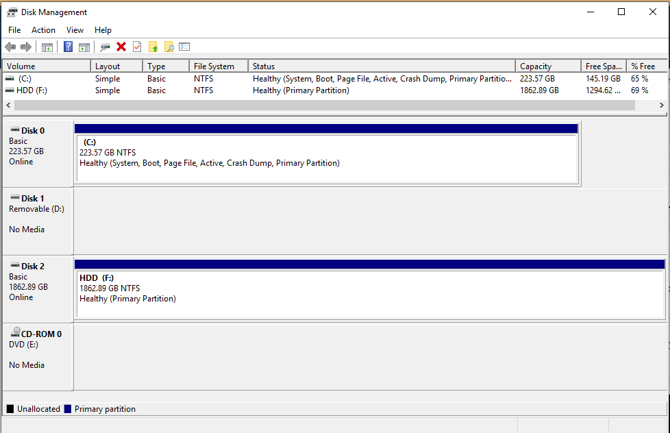

    Below is a screen shot of Disk Manager:
    Cannot boot with 2nd HD plugged in. Post Windows 10 re-install 1549828742627-png.png
