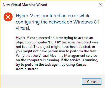

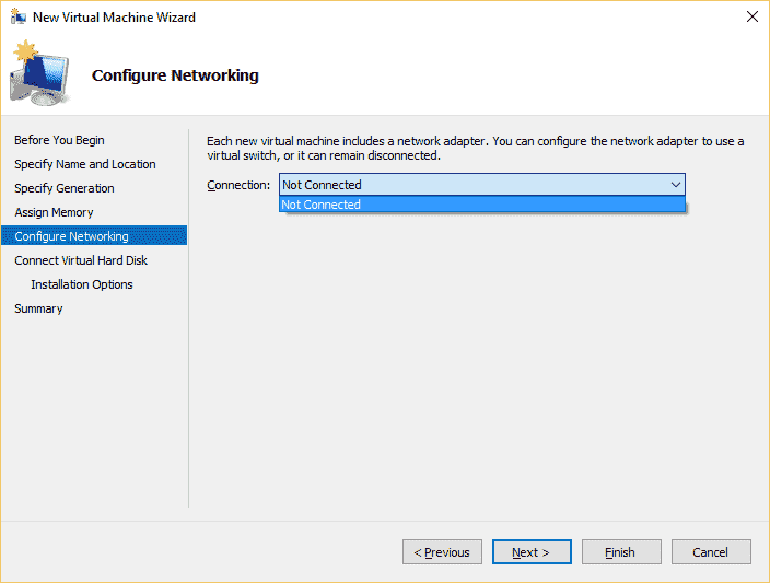

  3. DC91360 Win User
    Hyper V network issue
    So I'm trying to configure a new Hyper-V on my Windows 10 server. On the wizard, i get to 'Configure Networking' and I click the drop down on the connection to choose my network and it only has a 'Not Connected' option so I can't select a network (see image
    below).
    If I continue without selecting a network I get the error: Hyper-V encountered an error trying to access an object on the computer because the object was not found. (see second image below).
    I've gotten the same error on my workstation and my laptop.
    I have a network connection on both so I'm a bit lost. Any suggestions?
    Cannot connect to network in Hyper-V when using default network a3546304-d8bc-4147-8230-354d045e99c4.png
    Cannot connect to network in Hyper-V when using default network db62a860-fe11-4d9f-8e70-b530946c0ee3.png
    DC91360, Sep 13, 2018
