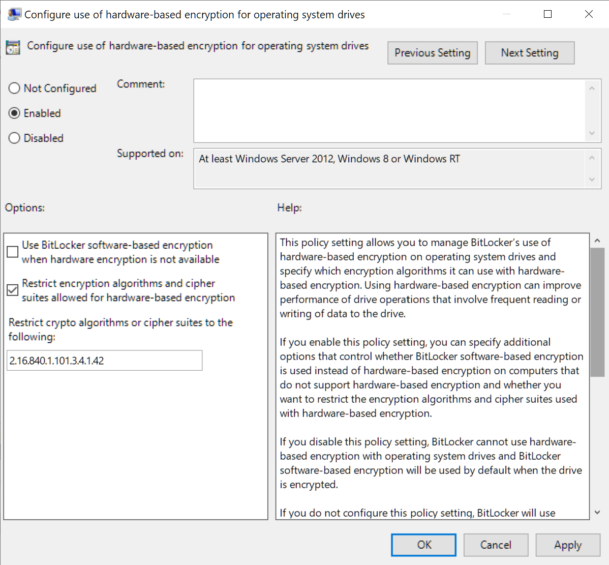

      • Set BitLocker through policies to force HW encryption Cannot get Hardware Encryption with BitLocker eDrive working Samsung 980 Pro 1TB 82eb1e7a-d067-4345-899a-d8723bc07563?upload=true.png

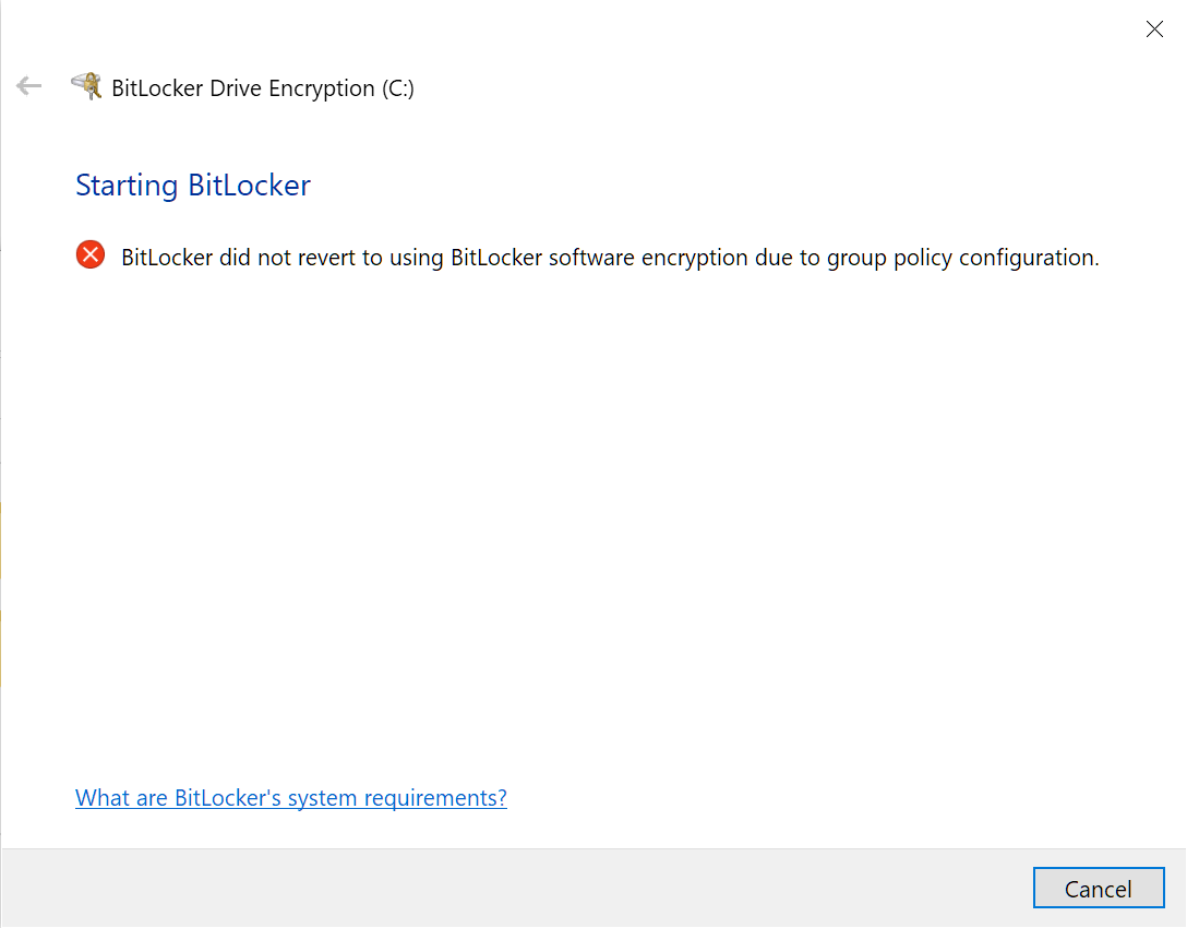

      • Tried to enable BitLocker on C: Drive - failed Cannot get Hardware Encryption with BitLocker eDrive working Samsung 980 Pro 1TB 264e8a0a-682b-42b6-b05e-fbbd54a75d76?upload=true.png

      • retried enabling BitLocker - still fails with the same Error with both the 970 Evo and the 980 Pro
    Conclusion
    I am doing something wrong... Or maybe something is broken with BitLocker, Windows or my motherboard.
