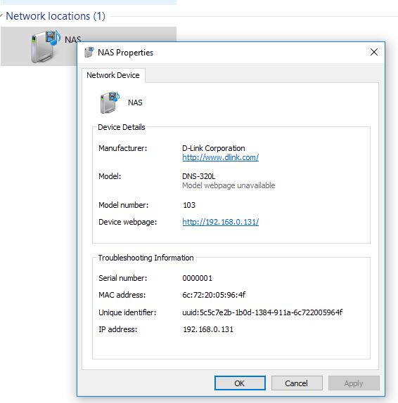

    The NAS (this is how I named it during the installation) is visible in My computer, but like a UPNP device
    Cannot Map NAS in Windows 10 Pro x64, however the device is accessible from the network f692e5be-d342-4a27-9b36-805e841e8fd5?upload=true.jpg
    Right clicking on the icon you can see information about the NAS, so its recognized

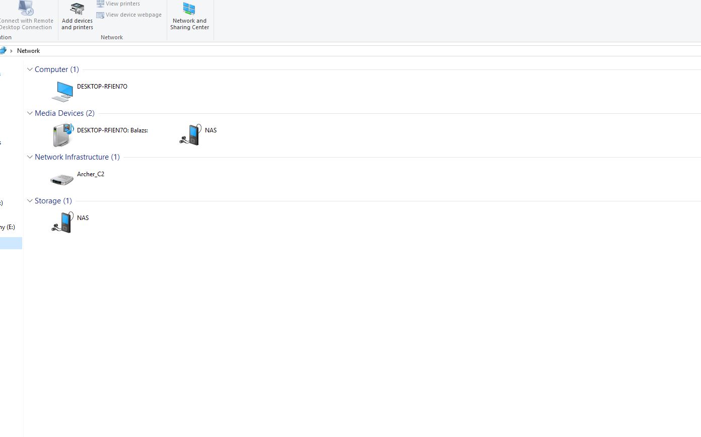

    Cannot Map NAS in Windows 10 Pro x64, however the device is accessible from the network f26d03b3-9102-4fbc-9842-9f63aeeb6366?upload=true.jpg
    if I open it I only find 3 folders there: Music, Photo, Video. But there is no option to delete, or create any files there..

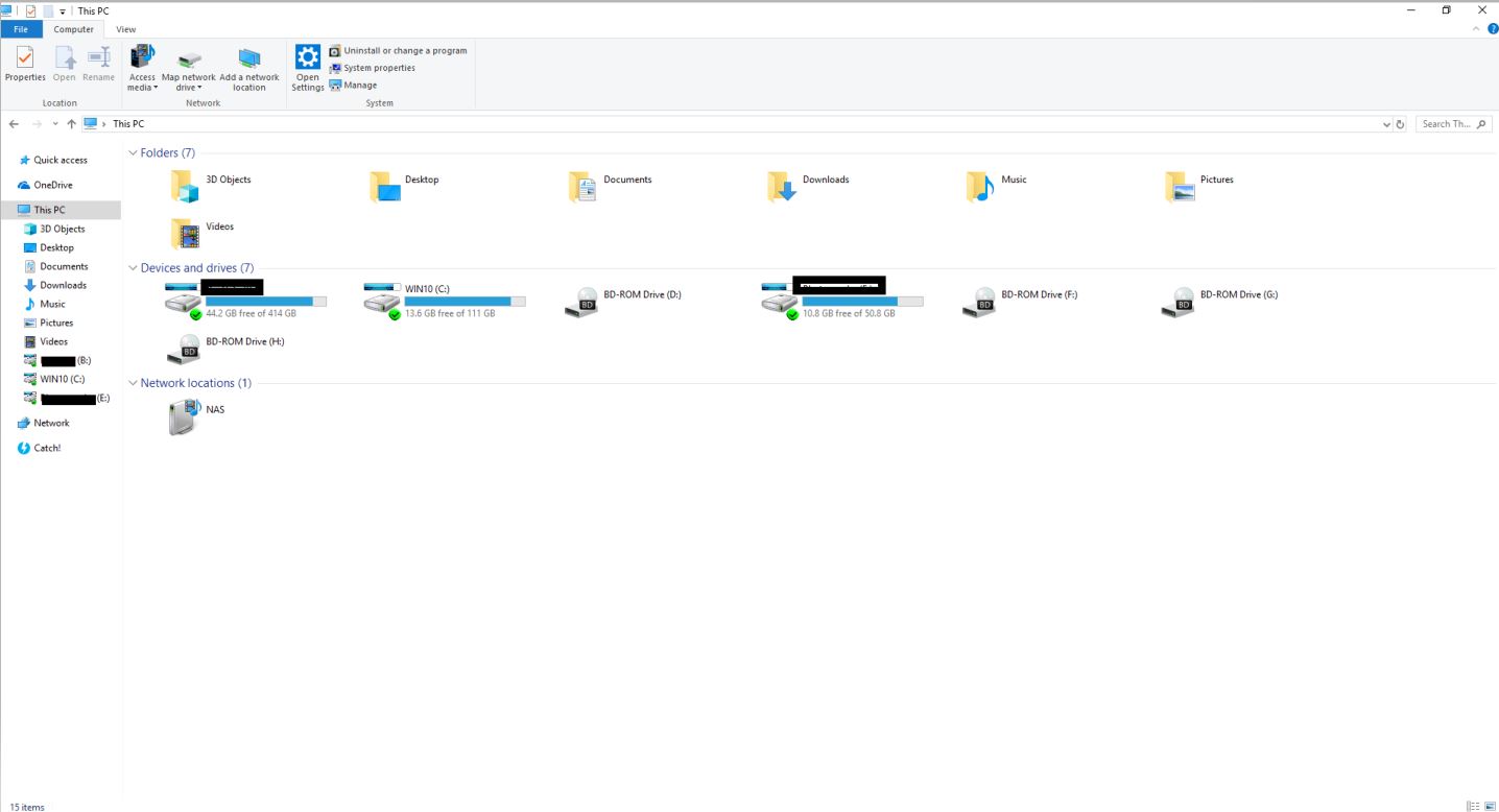

    Cannot Map NAS in Windows 10 Pro x64, however the device is accessible from the network d77fde27-a012-4a19-af66-336947bdee6c?upload=true.jpg

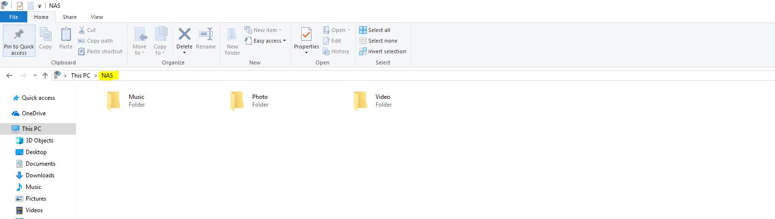

    Clicking on the NAS here opens up the device's admin console from the browser. Cannot Map NAS in Windows 10 Pro x64, however the device is accessible from the network e3672490-6a08-4969-be0e-15cdcff03ff4?upload=true.jpg

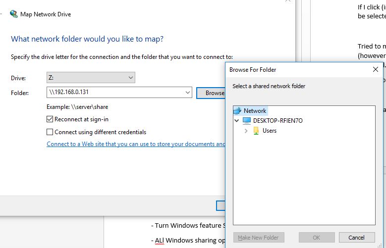

    If I click (in the Map Network drive tab) on Browse I only see the Network and my PC. If I click on Network nothing happens.
    Cannot Map NAS in Windows 10 Pro x64, however the device is accessible from the network f0e367ee-830a-4961-9a38-9f189bd6fd2c?upload=true.jpg

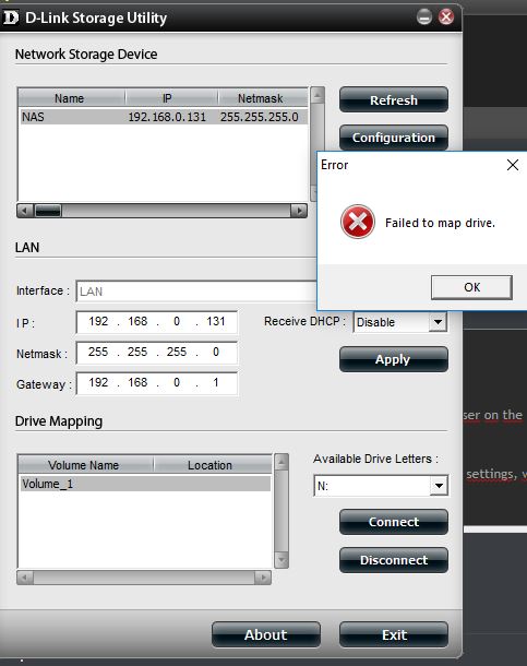

    Tried to map it with the D-link Storage Utility software, but it gives the error Failed to Map drive (however it recognised the NAS and all settings, it was asking for credentials as well which I gave and it accepted.
    Cannot Map NAS in Windows 10 Pro x64, however the device is accessible from the network 1621f5ec-6c05-457a-bf6f-556d9f40e786?upload=true.jpg
