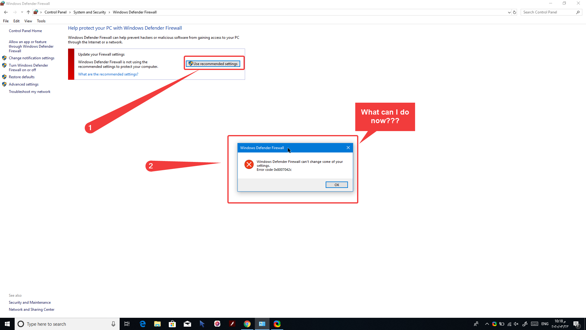

  1. Cannot turn on firewall or start its service! BFE issue not fixed after following steps...
    please help!!! I had it working from 2019, and after 2020 came, it stopped working.
    Here:
    Cannot turn on firewall or start its service! BFE issue not fixed after following steps... 0c2a11b8-705f-4a3c-aafc-bb8e86c4720f?upload=true.png

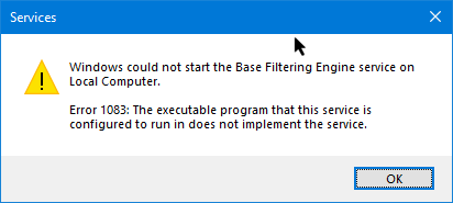

    Also, the BFE service has stopped working, launching it gives this error:
    Cannot turn on firewall or start its service! BFE issue not fixed after following steps... e58bf4c0-5208-4a42-bf75-abda29679e0b?upload=true.png
    I followed all the steps on this site: Fix Error 1083
    But the problem persists.

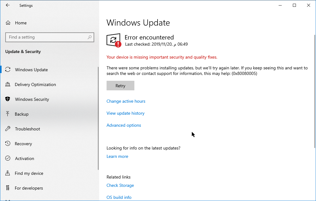

    Windows Update stopped working also:
    Cannot turn on firewall or start its service! BFE issue not fixed after following steps... fd91edf8-3134-453d-8705-97f9a3f1c4ca?upload=true.png
    It gave me: error code of 0x80080005
    Ran the troubleshooter many times, says detected and nothing happens...
    immediate help and reply please!!!!!
