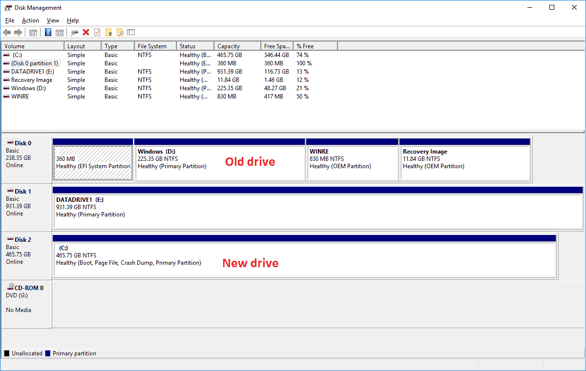

    My HP Envy desktop has been working well for three years, until we suddenly started seeing "Hard Disk Failure Is Imminent" error messages at startup. I ran the system diagnostics tool, and it reported that our SSD boot drive (we also have a 1TB HDD) was at 95% wear. (I was able to continue starting up after the warning.)
    So, I ordered a new SSD (Samsung 860 EVO) and hooked it up to the extra bay slot. I burned the Windows 10 utility/reset onto a DVD and started up from there. I selected to install Windows on the new drive and accepted all the defaults. (Note: I didn't make any partition selections.) All good so far.
    I can continue to startup (still seeing the imminent drive warnings, and then am prompted to choose which drive to use for loading Windows: Volume 9 (the new one) or Volume 3 (the original), and am able to startup from either. I was able to transfer files and reinstall software on the new drive. Still good.
    However...when I disconnect the original/old drive (with the expectation of retiring it), Windows refuses to startup ("3F0 error or Boot Device Not Found. Please install an operating system on your hard disk"). BIOS utility shows that it sees the drive, and all disk tests (including chkdsk) show good results. And, as mentioned above, if the old drive is plugged back in, the machine starts up and allows me to load windows from either drive. I tried booting from the Windows DVD and performing the automated startup fixes, but it reported that it could not fix anything (with no log files).

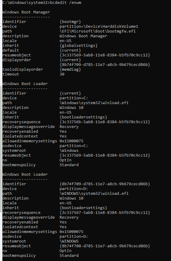

    So this feels like something is misconfigured on the new drive maybe? Here's the results of the bcdedit command (I booted Windows on my new drive, so C: reflects that), though I'm not sure if there's anything meaningful here:
    Can't boot from new drive 62eebfe9-9767-4fac-a4b6-89398a928acb?upload=true.png
    Perhaps more tellingly, the Disk Management utility reveals that the old drive includes four partitions (including EFI, which I believe is used for startup), whereas the new drive shows only a single partition...which does include "Boot", FWIW:
    Can't boot from new drive 1c671895-f0dd-4eee-82a0-43145980d05c?upload=true.png
    Is there anything else I can/should check?
