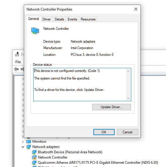

    When I right click on ANY of my network adapters and then on Properties, I am getting error "An unexpected error occurred":
    Can't check properties for any of the network adapters and can't install any drivers for... e0fff3c7-088d-4a16-badd-53b2170bf95d?upload=true.jpg

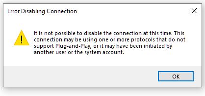

    If I try to disable any of the network adapters, I am getting error "It is not possible to disable connection at this time. This connection may be using one or more protocols that do not support Plug-and-Play, or it may have initiated by another user or the system account":
    Can't check properties for any of the network adapters and can't install any drivers for... 15e05e95-4b02-4233-a83f-a4e7b01100f0?upload=true.jpg

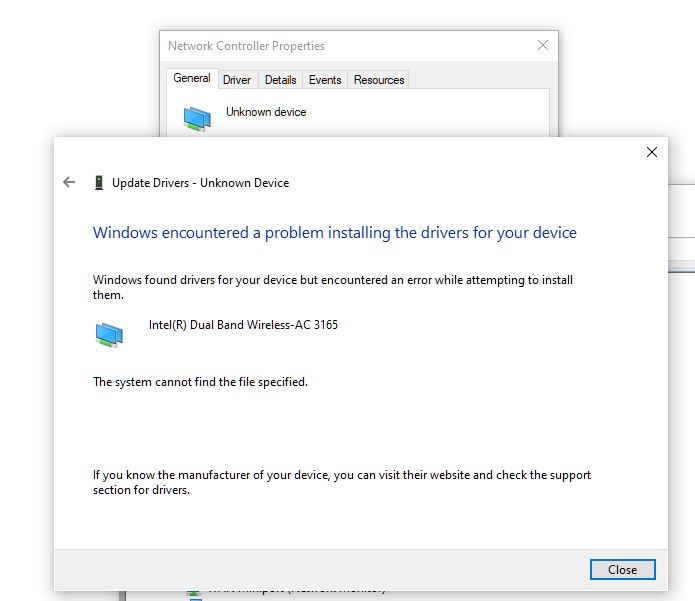

    When I try to scan for hardware changes, system fails to install the device back.
    Can't check properties for any of the network adapters and can't install any drivers for... e4f33f27-afb6-42ce-9e2f-e87e8b0252e8?upload=true.jpg

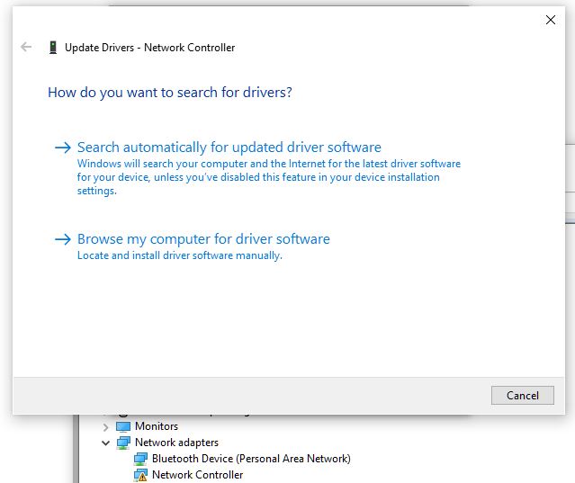

    Then I try to Update driver. Windows finds the driver, but fails to install it.
    Can't check properties for any of the network adapters and can't install any drivers for... 56291089-68a9-4f44-a833-2d83004b6642?upload=true.jpg
    Can't check properties for any of the network adapters and can't install any drivers for... 45bf652e-ce18-405b-a036-3b091d8909fd?upload=true.jpg
