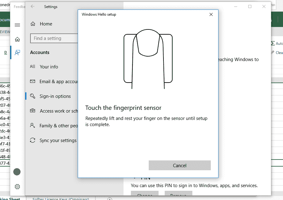

Discus and support Can't detect Fingerprint on my Windows Hello. in Windows Hello & Lockscreen to solve the problem; I checked the device manager it said working properly. so I go to setup my fingerprint and it is not available to detect my fingerprint on this device.... Discussion in 'Windows Hello & Lockscreen' started by Wyatt K, Nov 5, 2018.
  1. Wyatt K Win User
    I checked the device manager it said working properly. so I go to setup my fingerprint and it is not available to detect my fingerprint on this device. I have tried other product. It used to work fine. Now it won't work after I updated the new version of windows. Is there any way to fix this issue? Can't detect Fingerprint on my Windows Hello. 25c839e9-d297-44e9-80fe-f0258fabf586?upload=true.png

  4. Can't detect Fingerprint on my Windows Hello.
    Windows Hello Fingerprint Setup not working
    I have same issue with my laptop HP DV6 Pavilion.WIndows hello finger print setup is not working even after this above solution .When i setup finger print sensor i recieve error something went wrong.
