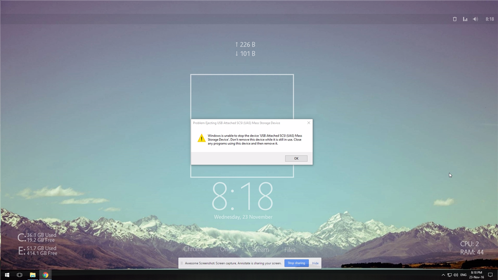

    step 1. try and eject the external hard drive. when the message pops up saying (PROBLEM EJECTING USB MASS STORAGE) do not close it.

  4. Can't eject external hard drive
    Every time that I try and eject my Samsung external hard drive, I get a message pop up saying to close any programs using it. I also can't eject using drive tools in File Explorer. I have checked and there is nothing running. I can also eject the hard
    drive in other computers, after using it for basically exactly the same use.
