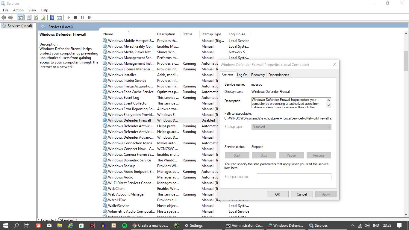

    can't enable windows firewall on services.msc and can't Reinstall the mpssvc
    when i open windows firewall error message like this '' The windows Defender Firewall with advanced security snap-in failed to load .restart the windows firewall services on the computer that you are managing Error code 0x6D9'' .Then I Open services.msc to restart the windows Defender firewall but i cant click anything on services msc windows defender firewall i have try many solutions on youtube or google but cant fix it .And i try reinstall mpssvc to solve that but cant to error message like this when i reinstall mpssvc in cmd
    [SC] StartService FAILED 1058:
    The service cannot be started, either because it is disabled or because it has no enabled devices associated with it.
    help my problem plis i need to get back my windows firewall thanks
    can't enable windows firewall on services.msc and can't Reinstall the mpssvc 873359f1-1bf4-4960-8b76-34d80c653876?upload=true.jpg
    AlvinF1, May 31, 2020
  2. can't start firewall
    Is that your computer? Based on the last screenshot, it looks, that Windows Defender was partially removed. If it was after install, SFC scan should fix it, but if it was removed from the setup, only reinstall would help.
    WF requires at least those 3 services to be running.
