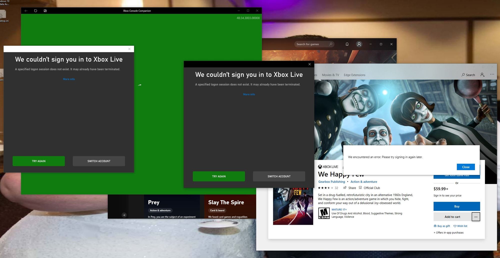

    I wanted to install the XBox Beta app for Windows 10 since I signed up for a month of the PC Gamepass. I did what the instructions stated to do and updated to the 1903 update for Windows 10. I was able to install the Xbox beta fine after the update, however, I'm unable to log into the app with my Microsoft account.
    I receive the error "We couldn't sign you into Xbox Live. A specified logon session does not exist. It may already have been terminated." I decided that maybe I might be able to install games via the Microsoft Store instead. However, I'm no longer able to log into it also as it gives me the error "We encountered an error. Please try signing in again later." I decided to install the Xbox companion app and I receive the same error as the Xbox beta error.
    What's weird is that I tried the suggestion I saw to create a new account for my computer and I'm able to log into everything fine on it. Something with this new update must have corrupted my main profile on my computer or something. Does anyone have any suggestions?
