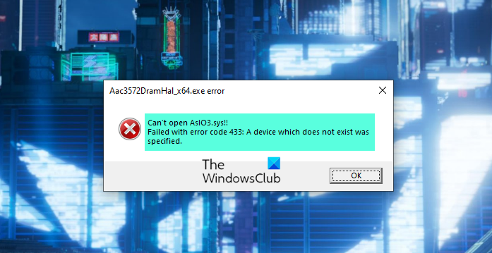

    Can’t open AsIO3.sys error on ASUS computers Cant-open-AsIO3-sys.png ​
    Some Asus users have experienced an error – Can’t open AsIO3.sys when working on their Windows 11/10 computer. This is an error that can prevent you from using your computer, as the system won’t be able to access this file. When this type of error occurs, there is something wrong with the registry entries or […]
