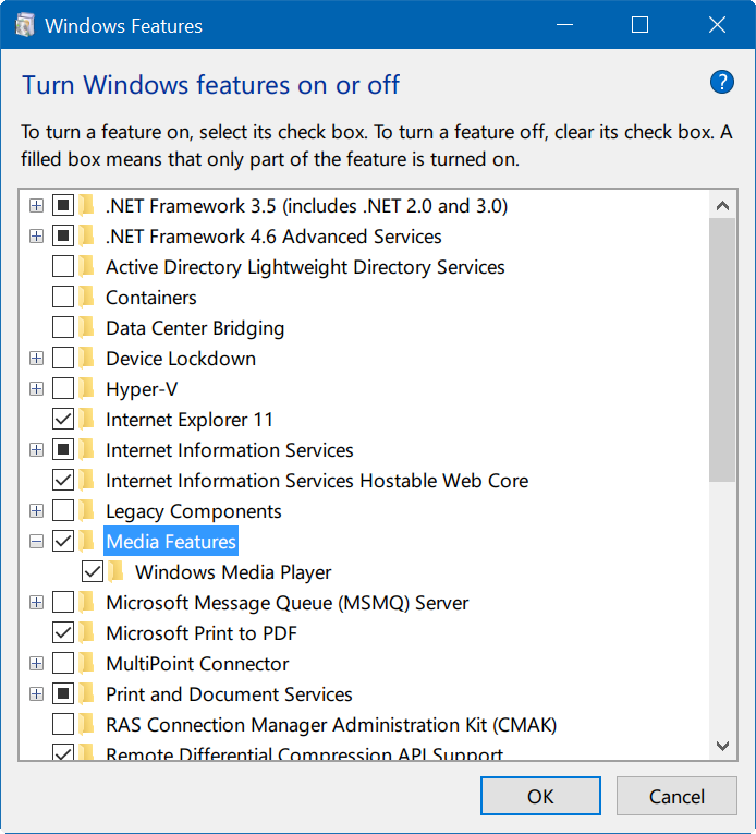

    Method 3: Check Windows media player.
    1. Press Windows and
      R key together on your Keyboard.
    2. Type appwiz.cpl and hit enter.
    3. Click on Turn Windows Features on or off on the left pane.
    4. Check for Media features.
    5. Expand Media features and uncheck the box which states
      Windows Media player.
    6. Click on Yes and Ok. Now, restart the computer.
    7. After the system is restarted, follow the same steps and check the
      Windows Media player option.
    Can't turn on Media Streaming 0c4f6f23-c931-404f-a0d6-7afc29b71f8e?upload=true.png

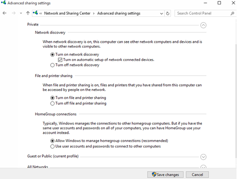

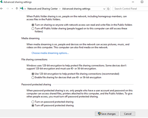

    Method 4: Advance sharing settings.
    1. Go to Control panel > Click on Network and Internet > Click on Network and Sharing.
    2. Click on Change advance sharing settings
      on the left pane.
    3. Select the options
    • Turn on network discovery.
    • Turn on file and printer sharing.
    • Allow windows to manage home group connection (recommended).
    • Turn on sharing so anyone with network access can read and write files in the public folders.
    • Use 128-bit encryption to help protect files sharing connections (recommended).
    • Turn off password protected sharing.
    4. Click on save changes.
    Can't turn on Media Streaming ef96030f-2095-4c85-bc32-8b96c8c63107?upload=true.png
    Can't turn on Media Streaming 5087751d-c33c-4daf-bef2-093c381f4cd8?upload=true.png
