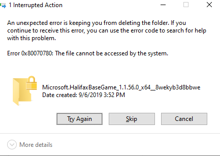

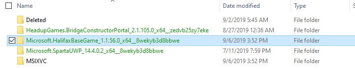

    I tried to move an app (more specifically Gears 5, a game from the Xbox app) to another drive via the "Apps and Features" menu. It was taking forever, and didn't display a progress bar, so I gave up and reset my PC thinking I would try again. Instead, the app has disappeared from the Apps & Features menu, and now any attempt to go back into the Xbox app and reinstall/redownload the game results in an error code (0x00000001), which I assume is because there is still a folder for Gears 5 in the "windowsapps" folder on both drives. Can't uninstall/reinstall app after corrupting the data. Unable to delete folder. 6551a960-10a5-401a-8f44-f2207bdc0d69?upload=true.png
    It appears the Gears folder (HalifaxBaseGame) is empty, as it says it has 0 bytes in the folder. But it's still causing a problem with the Xbox app. I've tried restarting my computer, reinstalling the Xbox app, etc. The only thing I can think would work would actually be a really easy fix: deleting HalifaxBaseGame and starting over. HOWEVER, for some reason every time I try to delete, or even access the folder, it gives me this error message:
    Can't uninstall/reinstall app after corrupting the data. Unable to delete folder. 0ed0a0a5-d3da-4c52-bacd-bfc05771f2e9?upload=true.png
    I am at my wits end here, and am absolutely BAFFLED by the amount of extra security and permissions that accompany all WindowsApps now. This should be such an easy fix!!!! But here I am, unable to delete a 0 byte folder and reinstall a game because of (what I assume is) some convoluted silly permission system Windows has implemented.
