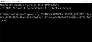

Discus and support Change Wireless Adapter power-saving mode using PowerCFG tool in Windows 10 in Windows 10 News to solve the problem; [ATTACH]Windows manages the Wireless Adapter’s power state to make sure it does not impact […] This article Change Wireless Adapter power-saving mode... Discussion in 'Windows 10 News' started by WinClub, Feb 27, 2021.

  3. There is no option of "power management" in configure internet adapter
    Hi joudalchahrour,
    Try changing the power plan for the wireless network adapter:
    Type powercfg.cpl in the search box then proceed by following the next steps.
    1-In Power Options click on Change plan settings.
    2-On the next page click on Change advanced power settings.
    3-On the next page expand Wireless Adapter Settings, then expand Power Saving Mode.
    4-In Battery powered and Mains powered, select Maximum performance.
