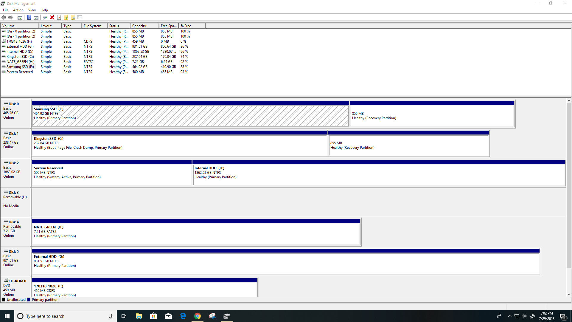

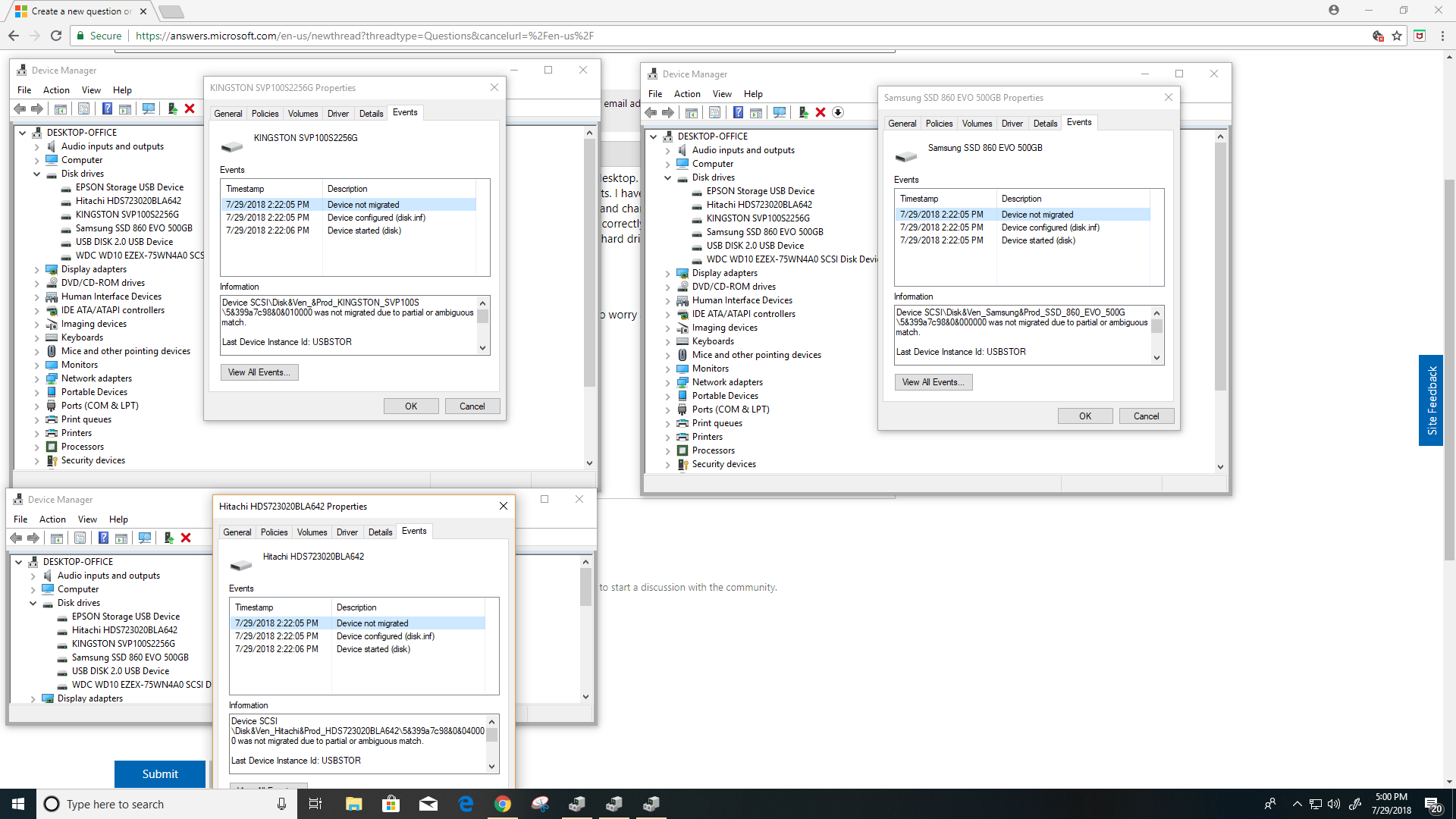

    Changed SATA ports SSD's and HDD: device not migrated due to partial or ambiguous match
    I recently cloned my old Kingston SSD to a new Samsung 860 EVO SSD and installed it into my desktop. When I installed it I just unplugged all of my SATA ports to take care of some cable management and they did not get plugged into the original ports. I have
    my boot SSD in port 1, the old ssd in port 2 (Havent formatted it yet) mechanical HDD in port 3, and optical drive in port 4. I went into BIOS and changed up my boot order so that the new SSD was the boot drive, and disabled the old SSD from the boot order
    to make sure things were working correctly. Everything appears to be working fine, but just by chance I happened to go into device manager and look at the event logs. It says on all of my hard drives: was not migrated due to partial or ambiguous match.
    Last Device Instance Id: USBSTOR
    The date and time correlate to when I physically messed with the cables and physically installed the new SSD.
    All of my drives are showing up in BIOS, in disk manager, and device manager. Do I even have to worry about this error? Images included below.
    Running an AMD Ryzen 7 1700 and an MSI Tomahawk B350 Mobo
    Changed SATA ports between 2HHD's and HDD: device not migrated c87e4e4a-4e42-4cde-b66e-b79462181fef?upload=true.png
    Changed SATA ports between 2HHD's and HDD: device not migrated 495126f9-e251-4a29-8eaf-0a16d1e0688a?upload=true.png
    N8terman, Jul 6, 2019
