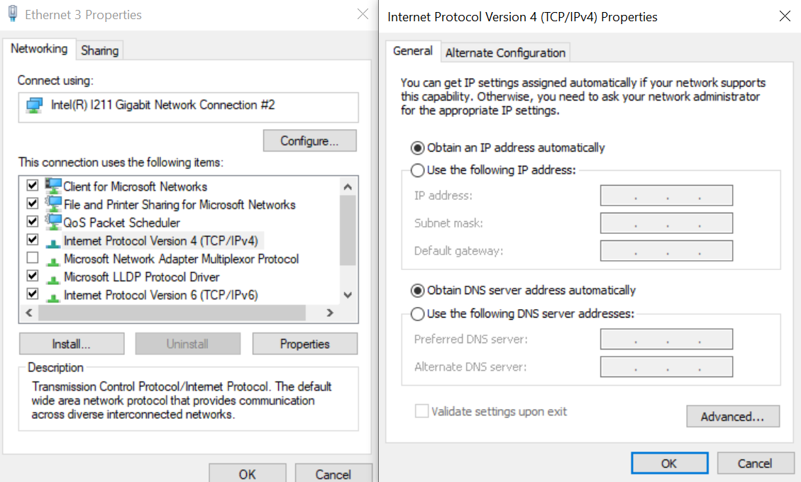

    Hello!
    I am running Windows 10 version 20H2, build 19042.685.
    When I try to configure manual DNS under my adapter properties, DNS no longer resolves and my internet does not function properly. Moreover, when I use a VPN service, the internet does not function, presumably due to the same issue.
    Some notes:
    • This is not related to my network. This machine has been taken to several different networks, and the issue has persisted on all of them. Moreover, I have configured severalother devices on the SAME network as the Windows 10 machine, all of which can use custom DNS or VPNs with ease.
    • This issue does not persist if I set my DNS to configure automatically.
    • The DNS server I am trying to use is not blocked on my network. Again, I have tried this on several networks so this should not be a concern, but I specifically tested it on other devices and made certain that any and all DNS servers I was attempting to use were in fact not blocked on the network.
    Troubleshooting steps already attempted:
    • Disabling antivirus Bitdefender
    • Uninstalling antivirus
    • Restarting several times
    • Trying to set custom DNS on WiFi as well as Ethernet adapters internet works on neither when custom DNS is configured
    • Resetting TCP/IP using netshell "netsh int ip reset"
    • Flushing DNS cache using "ipconfig /flushdns"
    • Disabling IPv6
    • Booting into Safe Mode with Networking and attempting to make DNS changes there
    • Running Network Troubleshooter it could not identify the problem
    Any further information on reasons this might be happening as well as possible solutions would be greatly appreciated!!
    See screenshot for a visual representation of how I am changing my DNS resolvers. On the second page "Internet Protocol Version 4 Properties", I choose "Use the following DNS server addresses" and enter in my DNS resolver.
    Changing DNS settings breaks internet connectivity e4f7d2f6-1415-43bb-a37d-9bf71bb3598e?upload=true.png
    SPS Sean S, Apr 16, 2021
