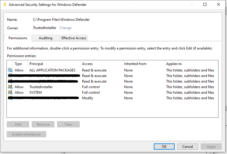

    I'm trying to uninstall windows defender as its bloating my pc and causing memory leaks, but task manager wont let me even close the program access denied
    My next thought was to delete the Windows Defender folder in my C: drive, but I need permission from TrustedInstaller to modify the folder.
    Upon trying to change the ownership of the folder, none of the accounts become editable I can't assign any permissions to the administrator and thus cannot change the ownership of the folder from trustedinstaller.
    Any tips?
    This is on Windows 10, for what its worth I haven't purchased a copy yet.
    idsbelf, Sep 30, 2020
  2. WindowsApps folder ownership
    As I know, the default owner for WindowsApps folder is TrustedInstaller. You can try restoring ownership to TrustedInstaller, refer first reply here for the required steps:
    Restore WindowsApps permissionss to TrustedInstaller
    Hope this helps!
    Kapil Arya MVP, Sep 30, 2020

  4. Barman58 Win User
    Changing folder ownership TrustedInstaller
    Override TrustedInstaller ownership...?
    First thing to do is to make a reliable system backup to an external device, and disconnect the device - this procedure can cause issues
    There is one system user that has higher rights to those of Trustedinstaller ... The hidden Administrator
    Enable the hidden administrator and log in as this user, once logged in you should be able to take ownership of the old Cortana folder, you may need to "break" the chain of ownership of trustedinstaller manually from the folder above the one you are attempting to remove by changing the ownership "Apply to Subfolders" - this is usually only needed if there system is seriously "confused" from what it should be and is normally a simple check box - once you have ownership of the old cortana folder and it's sub folders the deletion is the simple Delete command on the folder
    Barman58, Sep 30, 2020
