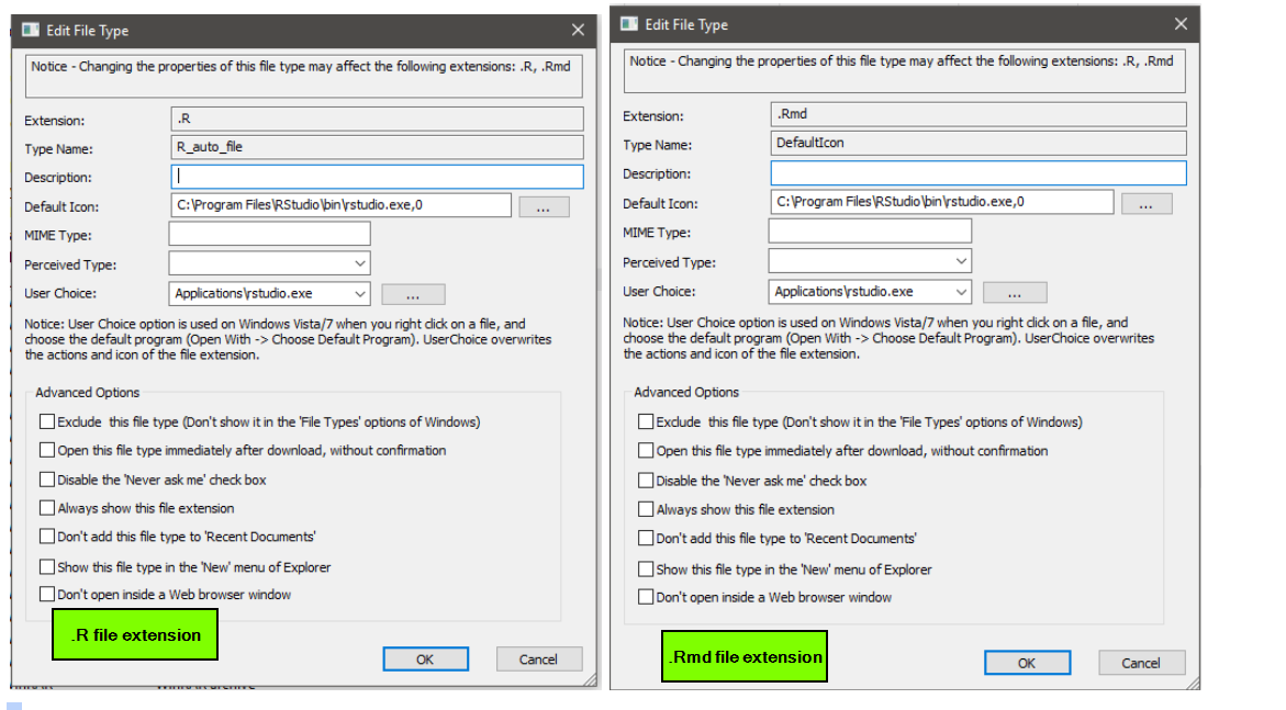

    I launched FileTypesMan and here is the view for both R and Rmd extension

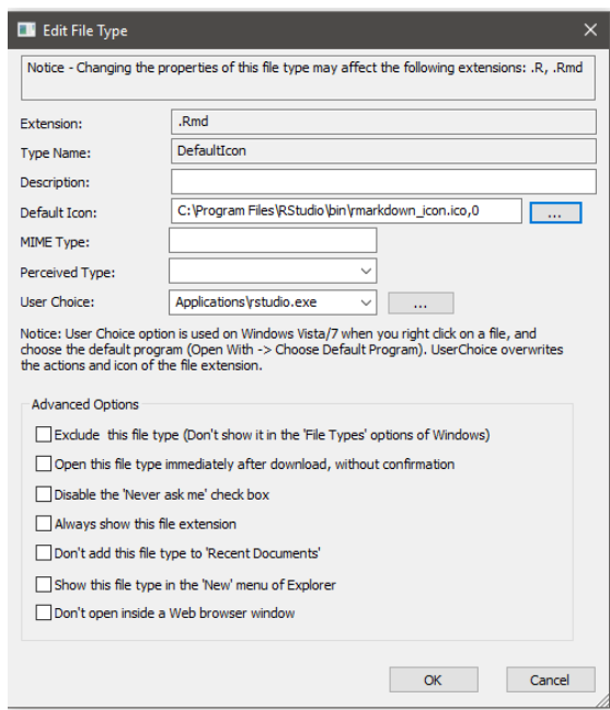

    I have an icon file which I have saved in the save location “rmarkdown_icon.ico”. I go back into FileTypesMan to try and change this, which seems to work

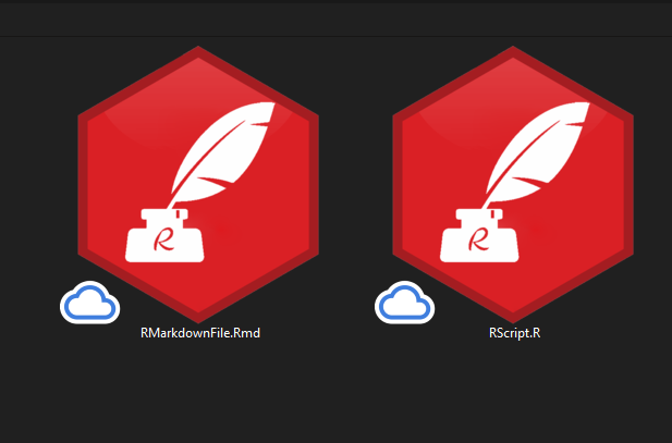

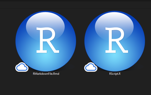

    The issue that both the R and Rmd extensions get changed (rather than just the Rmd extension)
    I have been attempting to change the icon with .Rmd using FileTypesMan but when I do it switches the icon associated with BOTH Rmd and R and I believe this is based on the "Rmd_auto_file" contained within the following path in regedit.
    HTML Code: Computer\HKEY_CURRENT_USER\Software\Microsoft\Windows\CurrentVersion\Explorer\FileExts\.Rmd\OpenWithProgids[/quote] As per my understanding based on some extensive Google searches, an icon is being attributed to everything that RStudio opens rather than a specific filetype (which is what we are trying to accomplish). I have attempted troubleshooting for quite some time and was wondering if anyone had successfully accomplished this.
    Does anyone have any insight to fix this?

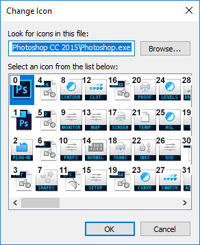

    A note about finding icons
    Often, an app's .exe will contain multiple icons. For example, the Photoshop.exe contains all the icons for all the different file types it supports. Here's how to find and use these icons:
    1. Create a shortcut to the .exe by right-clicking and selecting Create shortcut
    2. Right-click the shortcut and select Properties
    3. Click the Change Icon button near the bottom
    4. You will now see a window like this (but without the numbers):
    5. The icons are numbered starting from 0. Find the number of the icon you want to use. Instead of counting, you can use the formula (column - 1) * 4 + row - 1. For example, if the icon is in column 6, row 3, (6 - 1) * 4 + 3 - 1 = 22
    6. Now you can reference that icon by including the number in the path to the .exe like so:
      C:\Example\Photoshop.exe,23
