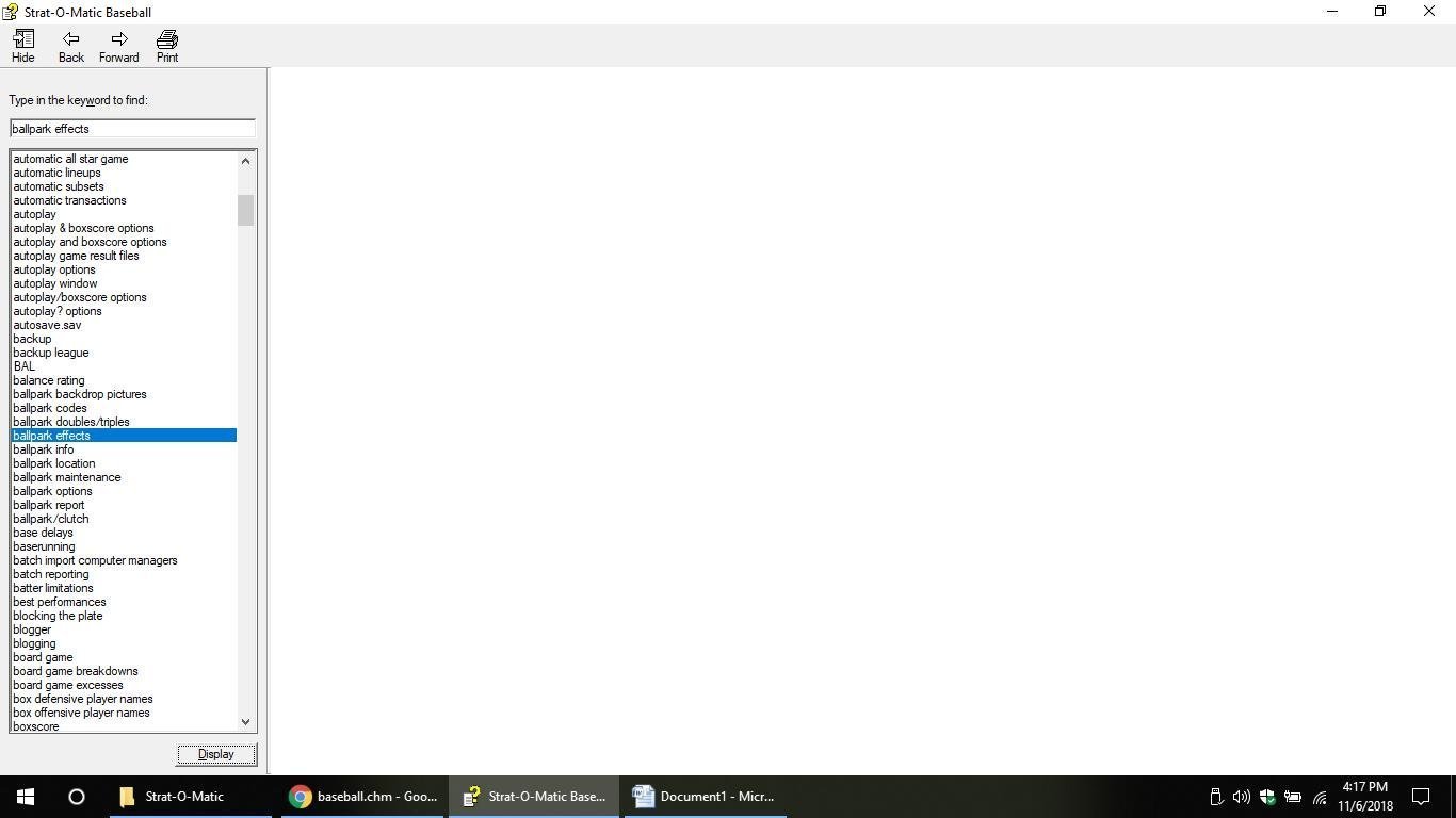

    I am trying to open a .chm file in Windows 10.
    I am only getting the menu on the left, see below
    .chm file opening problem a813ccc4-eb94-487a-840a-9ab3a437961d?upload=true.jpg

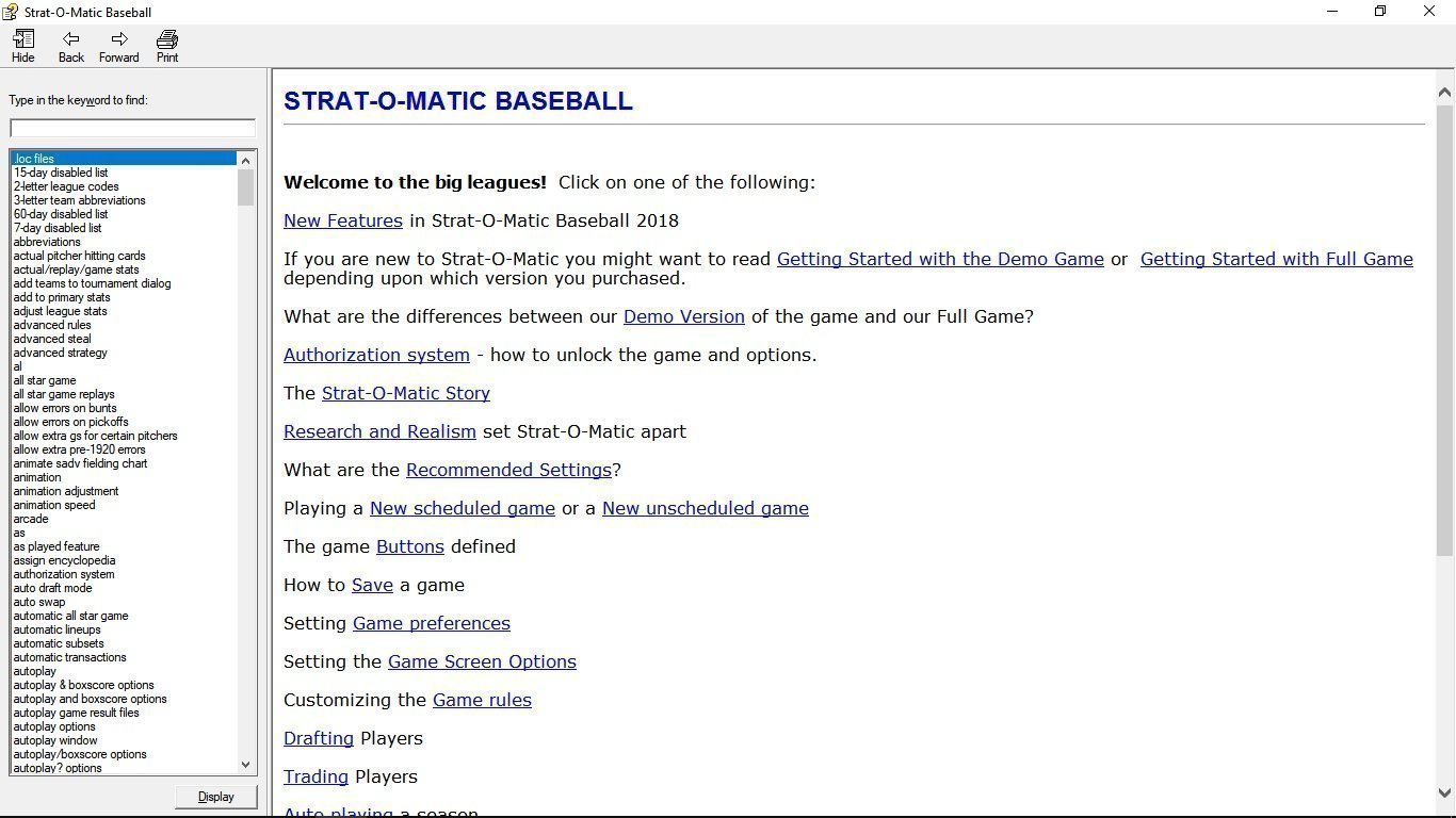

    it should look like this with an index on the left and links on the right. Any one have a suggestion.
    .chm file opening problem e8a99328-3a9a-4afe-acb6-9d5b74810bc2?upload=true.jpg

  2. DaveM121 Win User
    can't open CHM file on win10
    Hi xalspaero
    Chm files should open in Windows 10 without any issue
    Right click a chm file and choose Open with
    Does Microsoft Help HTML Executable appear in the list?
    If not, scroll down and click 'More Apps'
    Again check for Microsoft Help HTML Executable, if that s not in the list, at the bottom, click 'Look for another app on this PC'
    Navigate to find: C:\Windows\hh.exe
    If that file does not exist, click the link below to download HTML Help Workshop and Documentation, which will contain hh.exe
    https://www.microsoft.com/en-us/download/detail...
    DaveM121, Nov 8, 2018

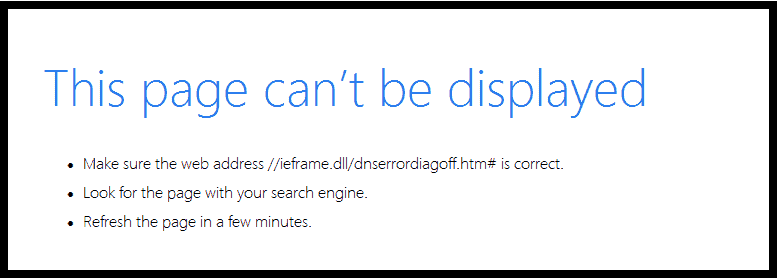

  3. CHM not opening from network folder
    I can't find anything answer to my problem:
    One user complained that he could not open CHM file.
    Error:
    .chm file opening problem 97ebb69d-0345-4621-b90a-c7f30c19c782?upload=true.png
    He mentioned, after vacation everything worked.
    What I found:
    .chm not opening from network folder, after copy this file on desktop, problem solved. But the person is working with much .chm document, and copy all uncomfortable.
    What I tried:
    • Change HKEY_LOCAL_MACHINE\SOFTWARE\Microsoft\HTMLHelp\1.x\ItssRestrictions MaxAllowedZone to 1;2;3;4
    • Create UrlAllowList in regedit.
    • Uninstall last installed windows updates.
    • Open from another (administrator) user on this pc.
    • Change location of .chm file f:\ g:\ and other mapped disk, or open path with ip: \\192.168.1.1\folder\file.chm
    • No "#" or "%" symbol in file name or path.
    • No choose "unblock" in properties.
    • Other computers with same windows from image, can open this file from network folder.
    Maybe you have more ideas? Thanks.
