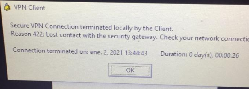

    Cisco VPN Client lost conection only wifi after windows 10 2004 and up 20H2 Cable works ok
    I have a bug with Cisco VPN Client, it only does it with version 2004 onwards.If I am connected by wifi and I connect to the Cisco VPN, the pc automatically disconnects after 26 seconds, what happens is that the pc is placed in airplane mode when it detects that it does not have internet and then this disconnects the Cisco and gives that error, it is just by WIFI that does that.Also several people have the same with this after upgrading to Windows 10 2004 version above.If I do the cable connection it works fine and it does not disconnect and it is well stable in several PCs with this Windows the same.Please if you can give a solution to this error, thank you very much.God bless you very much!
