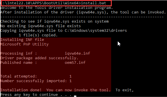

    • If you receive the error to reinstall a missing or corrupted driver when attempting to run this command; within command prompt, navigated to the same directory of ...\Intelxxxx\APPS\BootUtil\Winx64\, type in the following command:
      • install.bat
        • This will effectively install the necessary driver to use this specific utility correctly (all of its intended features). You may then re-run the original command specified in the above steps.

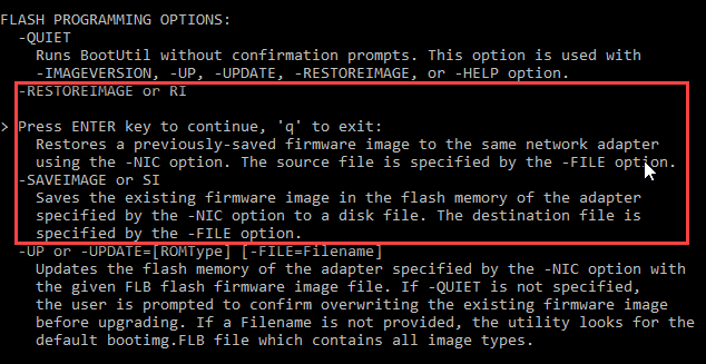

    class config code 56 Inte ethernet connection i218-V 0a67ca0a-3958-45d2-8f96-3655e0904520?upload=true.png
    Type in "bootutilw64e.exe -HELP" within command prompt to see the list of commands/triggers available and details for each command/trigger.
