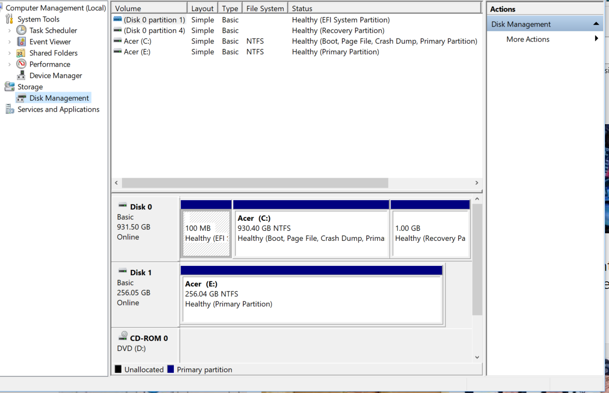

  3. alden2662 Win User
    How to change boot from HDD to SSD?
    Thank you for the advice, I followed your instruction, went to F2 in BIOS and changed sequence of bootable disks putting SDD on top of HDD, so it was on BIOS like this :1) Windows, 2) SSD Crucial; 3) Toshiba HDD ( original drive).
    But results were pretty suprising: booting did not cut by 80% like some people say it will if boot will go from SSD instead of HDD. It looks to me booting from SSD is even longer than from HDD and I now wonder if cloning was done correctly, may be it something
    wrong with partition?
    I checked disk management and copied image from it. Disk 1 (SSD) shows Healthy (primary partition) and HDD shows Healthy (boot, page file, crash dump and primary partition). SSD is missing page file, crash dump) May be it's the reason why SSD boot is slow?
    And if I will have to erase my cloned Windows from SSD is it possible to clone it again to the same SSD may be using different software?. I am afraid if I format SSD to re-clone my HDD, it will erase not just my Windows and some other apps on SSD but also
    it will erase installation software that came with SSD. I will appreciate your advice.
