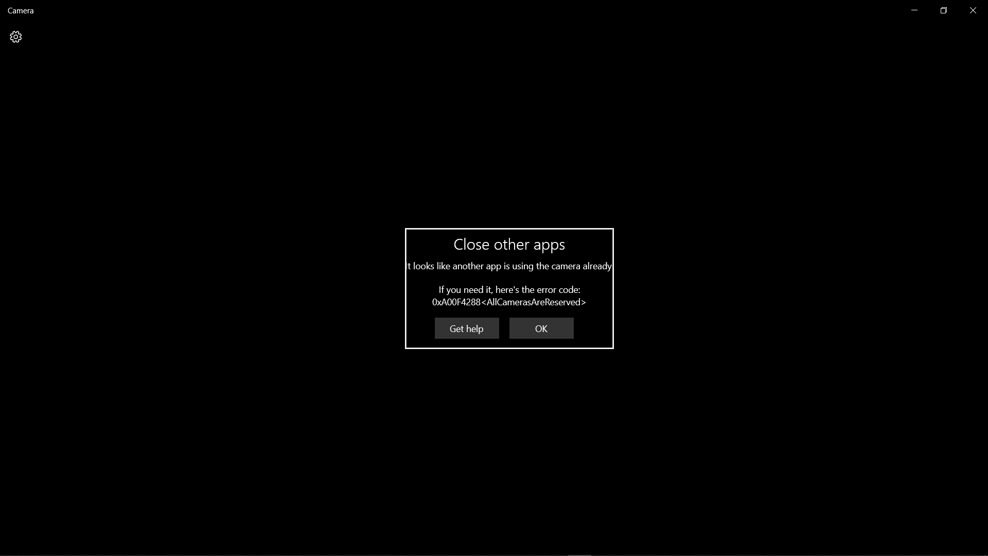

  1. "Close other apps" Error on Microsoft Camera
    I updated my all apps through the Microsoft store. After that Microsoft camera app is not working. All the times when I open it, this error message appears. I reset It couple of times. But still, it is not working.
    "Close other apps" Error on Microsoft Camera e6e07285-b583-46b6-98c3-44377706ab77?upload=true.png
    Dineth_Yasuru, Jul 31, 2020
