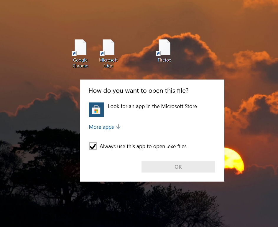

  1. cmd, task manager and all .exe files does not open
    All shortcuts icon turn into blank white as shown in image.
    and whenever i open command prompt, task manager and any .exe files , one pop up window appearHow do you want to open this file? as shown in image.
    cmd, task manager and all .exe files does not open 53e47391-0395-4bf2-a113-2d59a1aa9644?upload=true.png
    I tried,
    deleting iconcache.db files and restarting my computer but it won't work for me.
    I saw related Que and it's solution but probably all solutions required at least running cmd. But in my case cmd does not open.
    It is frustrating.
    Please help.
    Dhruvil Dholariya, Sep 12, 2020

  4. Alden Rey Win User
    System Restore Error 0x800700AA and Task Manager
    Thank you for your response. Some of the common symptoms of (0x800700aa) are unfinished installation of Windows application, virus infections, inaccruate registry entries, corrupt system files, incompatible or outdated software or hardware, unfinished uninstalling
    of some files, clashes between the automatic update error and the computer, installing of some corrupt or infectious apps or files, etc. In this case, we suggest to run a clean boot on your computer. Kindly follow the steps provided by
    Stephanie Sal on this
    link
    Regarding about the Task Manager concern. Malware may prevent opening of Task Manager. So you may want to clear your computer junk files and then run a full or deep scan with your antivirus or security software or Microsoft Security Essentials. If you're
    done running those tests. We suggest to run DISM and SFC. By doing so, the task will scan for changed or misplaced files. If sfc discovers that a protected file has been overwritten or corrupted, it retrieves the correct version of the file folder, and then
    replaces the incorrect file. Kindly follow the steps below to perform the task:
    Run DISM and SFC
    • Open an Administrator CMD window. If you can’t find a way, use these steps:
      • Press CTRL+Shift+ESC to open Task Manager.
      • Click File > Run New Task.
      • Make sure you have a check mark beside “Create this task with administrative privileges” .
      • Type CMD.
    • Type the following commands at the CMD prompt:
      • dism /online /cleanup-image /restorehealth
      • sfc /scannow
    • If neither command shows a good result, go to Reset your PC.
    If none of the above options work, review the different recovery options available in Windows 10. The
    “Keep my files” option should work – Reset your PC > Option > Keep my files.
    If you're unwilling to reset the PC, you can try uninstalling the antivirus software, and do an in-place reinstall.
    Should you need further assistance, feel free to get back to us.
    Regards.
    Alden Rey, Sep 12, 2020
