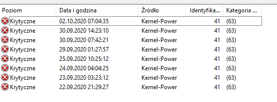

    Here is a list of my hard reboots:
    Computer freezes with buzzing sound, no bsod on freshly installed Windows 10 2004. Please help. ebec64a7-000b-4eac-96b7-83a9a782d7e6?upload=true.png
    So it happened 8 times already. During those 8 times Windows created only 1 minidump file.

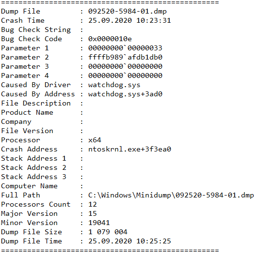

    Computer freezes with buzzing sound, no bsod on freshly installed Windows 10 2004. Please help. d7ccbe7d-13a9-4554-9233-3924b4d69534?upload=true.png
    You can download it here: https://www34.zippyshare.com/v/jf0Nmqi1/file.html
    As you can see the dmp file was created at 10:23:31 and I rebooted the PC at 10:25:12.

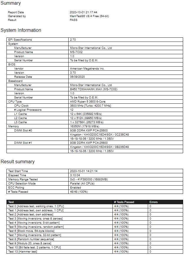

    I thought it would be a good idea to check if memory is ok so I ran memtest86 yesterday when I went to bed. Here are the results:
    Computer freezes with buzzing sound, no bsod on freshly installed Windows 10 2004. Please help. a715389a-3e25-4993-b93f-fe8722543604?upload=true.png
