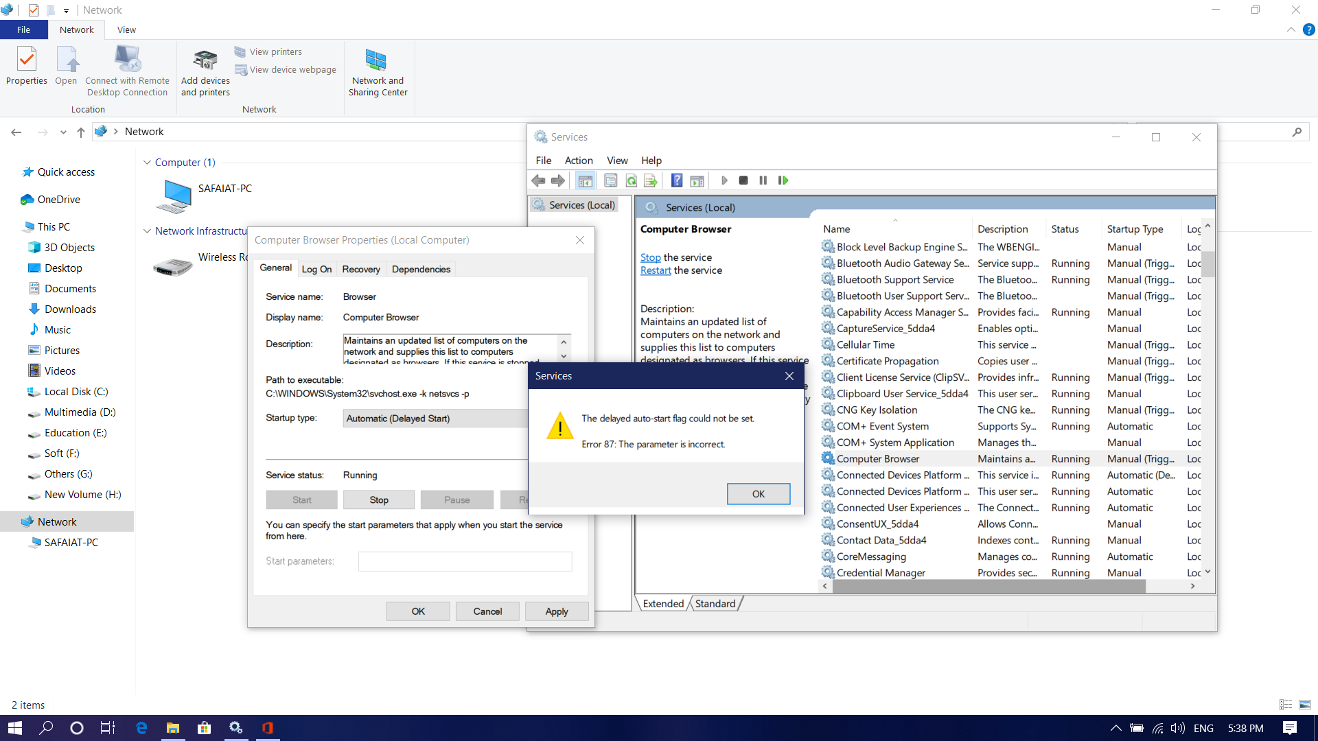

  1. Computer network and sharing center is now showing any local devices
    As the Network and sharing center is not showing any other devices. i googled that if Service.msc>computer browser and set it to automatic(delayed) it might work. And for the 1st time it worked. But after few days it stopped working again. While fixing it again to automatic(delayed) it shows "the delayed auto start-flag could not be set Error 87: The parameter is incorrect. I also tried the settings>update & security>recovery>reset>keep all data but didn't worked .Need help urgent. I couldn't access my nas storage. How to solve it??
    Computer network and sharing center is now showing any local devices dd04d948-81b3-470d-872f-c4289a6af8a1?upload=true.png
    Safaiat Hossain, Aug 14, 2019
