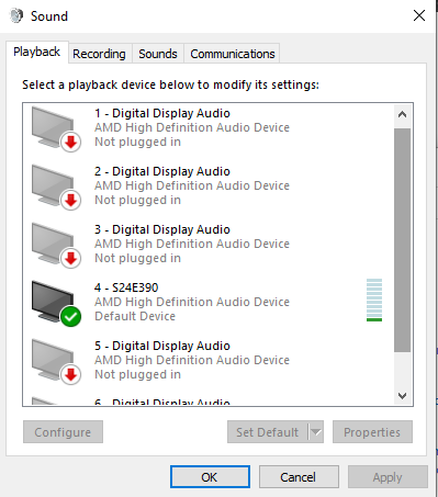

    After an update, my computer is only playing back sound through my Samsung monitor which has no speakers. I have my speakers, headphone and mic plugged in but none were detected.
    Computer only plays back sound through monitor which has no speakers 82901b6f-b6a9-4d5e-91cd-498d72d491bf?upload=true.png
    guicheng0628, Apr 28, 2020

    This issue causes because the monitor automatically takes the HDMI sound as the Default input. Disable and enable the speakers and check if it helps.
    I suggest you to try the below steps and check if it helps.
    • Right click on the volume control and then
      Properties
    • When you connect the HDMI it becomes the default output device, even though it has no speakers.
    • You need to change this back to "Speakers" and set as default.
