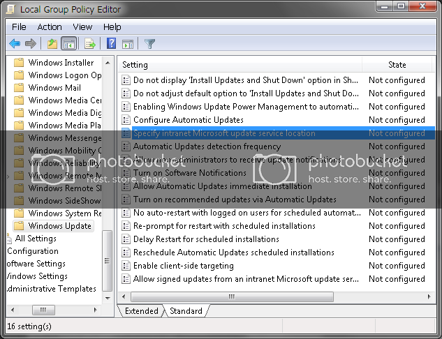

    - Click the Orb at the bottom left of the desktop aka 'Start' button
    - In the search field enter GPEDIT.MSC
    - In the Local Group Policy Editor (LGPE) console that appears, navigate to: Computer configuration > Administrative Templates > Windows Components > Windows Update
    - Double click the Specify Intranet Microsoft update service location Group Policy setting. Note that Not Configured is showing in the State column
    Computers running various old versions of Windows show in WSUS as not needing any updates WSUSsetup01.png

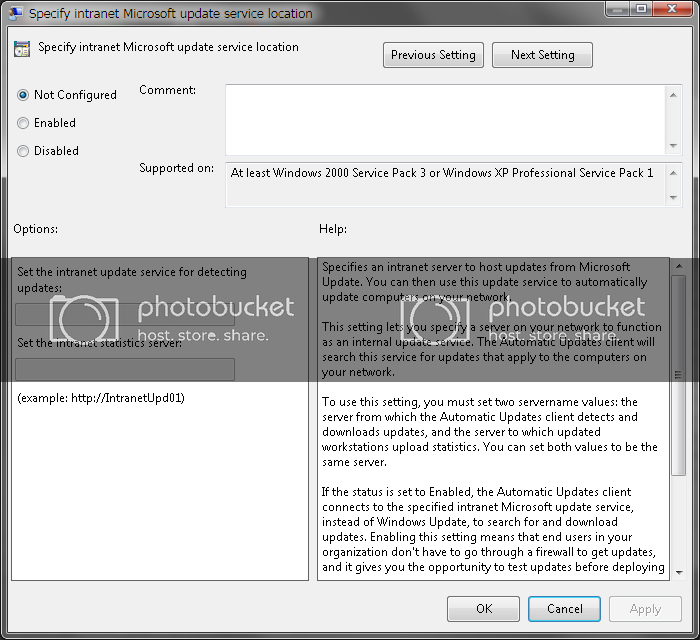

    - The dialog box opens. Note that the Not Configured radio button is selected
    Computers running various old versions of Windows show in WSUS as not needing any updates WSUSsetup02.png
    - Enter the server details, by clicking the Enabled radio button and entering the same details in both Options fields. The server's name is the standard Windows name. My server is called afterburner *Smile Computers running various old versions of Windows show in WSUS as not needing any updates :)

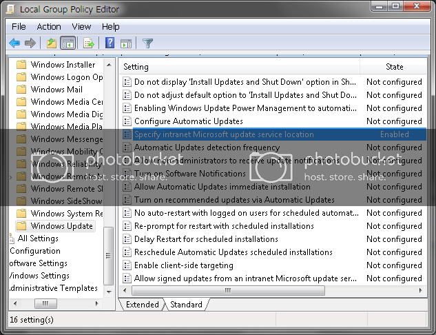

    - Click OK. The main LGPE window now looks like below. Note that Enabled is now showing in the State column.
    Computers running various old versions of Windows show in WSUS as not needing any updates WSUSsetup04.png

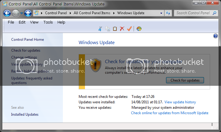

    - Open the Windows Update window. It should now show You receive updates: Managed by your system administrator
    Computers running various old versions of Windows show in WSUS as not needing any updates WSUSsetup05.png
