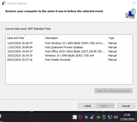

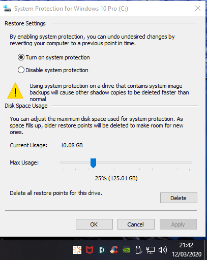

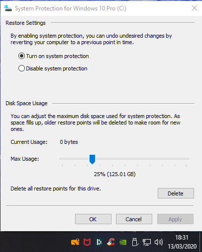

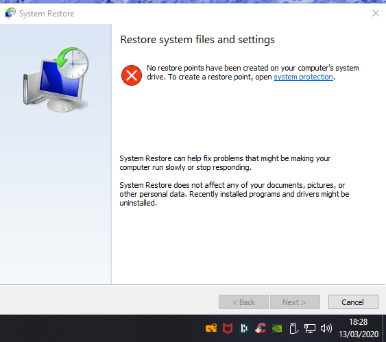

    I am currently running Windows 10 v1909 Build 18363.720 x64 on my Dell Inspiron 3670, and I'm having issues regarding corruption of Windows' 10 restore points.
    Corruption of Windows 10 Restore Points 4558e2c9-a50b-46b8-b46d-8e7066b57a28?upload=true.png
    Corruption of Windows 10 Restore Points 8b01ff24-1332-4382-99be-92de2a5e0deb?upload=true.png
    Corruption of Windows 10 Restore Points 9522f30f-de5b-4a05-9c75-ea5b57d5ee86?upload=true.png Corruption of Windows 10 Restore Points 1b6afb38-637e-4b1e-b5d8-081a1938974b?upload=true.png
    Dell have been looking into this issue on my behalf and come up with the following
