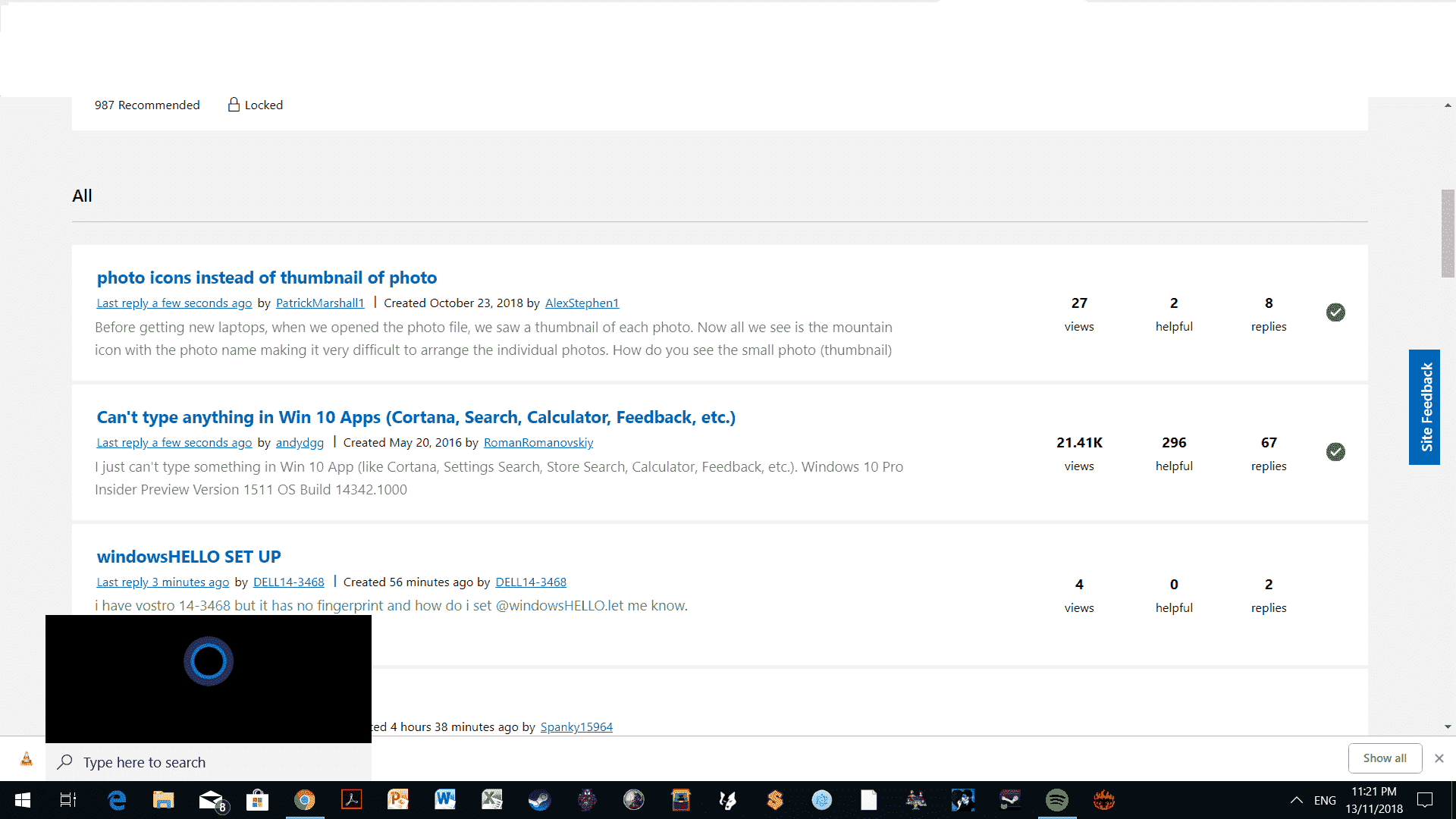

    I'm currently experiencing a bit of a strange problem. I have a Beoplay A1 speaker that I often use with my laptop running Windows 10, however while using it I will constantly be interrupted by a search box pop-up. I have been unable to identify why this is happening. This problem has been going on for months now. Would appreciate any help.
    I have included a screenshot of the search box that pops up. Cortana Search Pop-Up while Bluetooth Speaker is On b3433011-3868-4e91-ba11-d41116e217fa?upload=true.png

    I believe the problem is cortana is trying to use the bluetooth speaker as a mic.
    - Click underneath Microphone (in Cortana settings) where it says Make Sure Cortana can hear me "Get Started".
    - It will then have a Speech screen where it asks you to select the Device to troubleshoot.
    - I changed from the non-existent mic in the bluetooth speaker to internal speaker in the tablet.
    - Ran through the test.
    Now Works!
