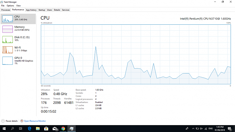

  4. CPU throttling after plugging in charger cable windows laptop.
    Dell CPU Throttling while charging (0.46 GHz)
    This is my laptop's issue when it's been bought. When it is plugged in, it is throttled to 0.48 GHz
    CPU throttling after plugging in charger cable windows laptop. 190789d1527831954t-dell-cpu-throttling-while-charging-0-46-ghz-screenshot-52-.png
    , while if it is not charging, it can go up to 2.56 GHz. I tried removing the battery and plugged the charger, but it is still throttled. What can I do? Thank you for the future answers.
