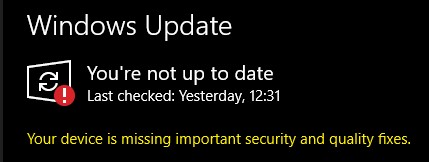

  2. Windows Cumulative Updates Installation Failed(0x800f0831)
    I'm facing problem with installing Windows Cumulative Update from nearly 2 months!!!! My laptop is installing all the other updates except the cumulative updates with error code 0x800f0831. I tried various solutions for the problem but I couldn't make it
    out. Please help me regarding this problem.
    I also want to know that whether this is a minor or major problem and can I install Windows major update
    (19H2)without installing these cumulative updates?
    Cumulative update KB4530684 fails with error code 0x800f0831 4fd33d3b-27e1-4b50-89fd-2281e041e746?upload=true.jpg
    Aditya1002, Dec 26, 2019
